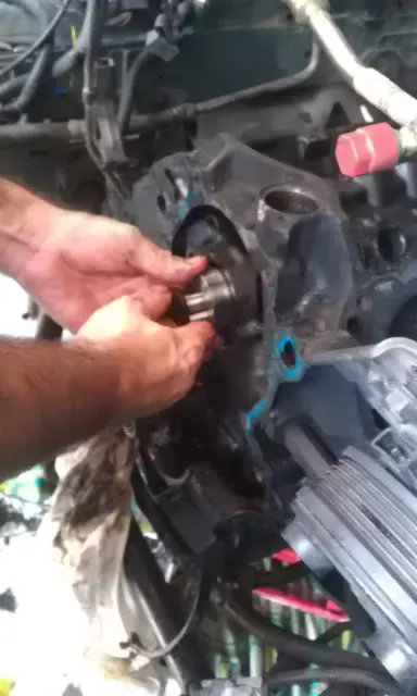

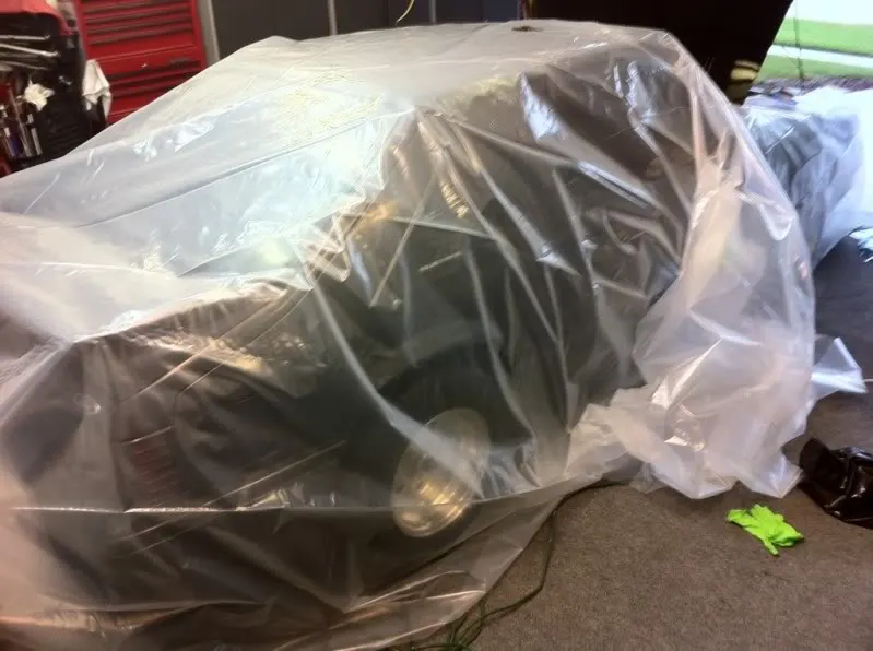

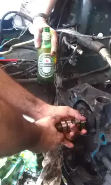

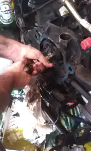

Camshaft removal and installation today.
There were Heineken requests so Roger obliged.

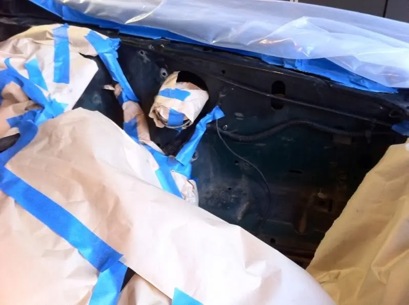

Doing some prep work. Have a polish and black theme going.

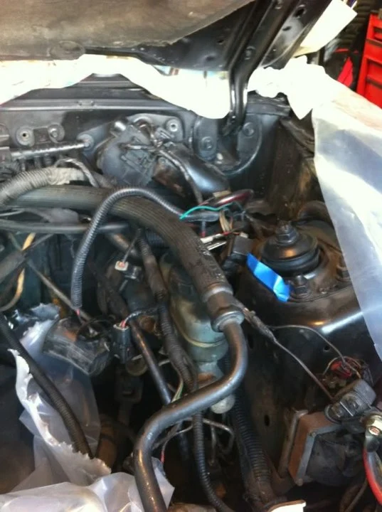

The sensor looked out of place with a polished induction.

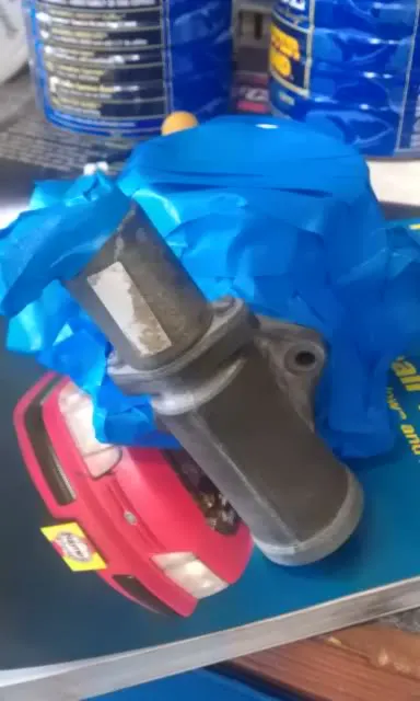

After
Painted timing cover, water neck, brackets and little items.

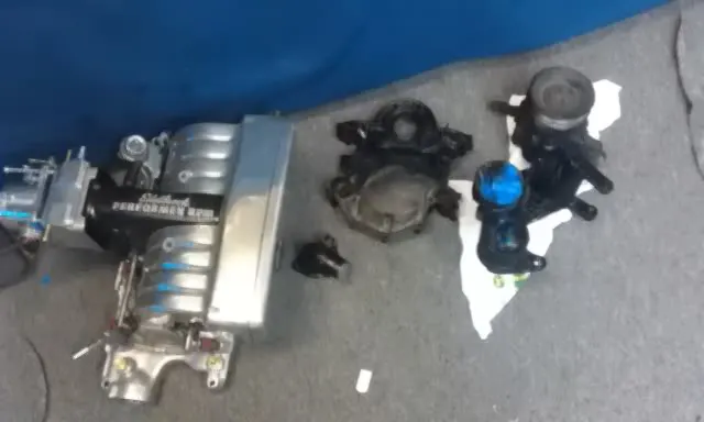

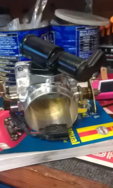

After

Puncturing a can of spray paint to get the paint out = Terrible idea
Although I do wish I was there to watch.....the picture looks quite entertaining. Did Allie cry after painting her nails black?
Paul, the Heineken request had been made and Rog delivered (a few times).
The spray can was a good idea since it was never shaken (charged). However it wasn't until after I was told that my son shook the crap out of it. I didn't know air brush machines put out that much overspray. If that were the case, overspray is less with a regular spray can. Although the air brush machine can get into tighter spots which is what we are using it for anyway.

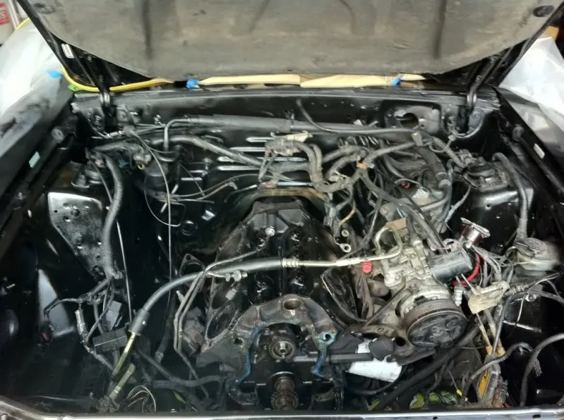

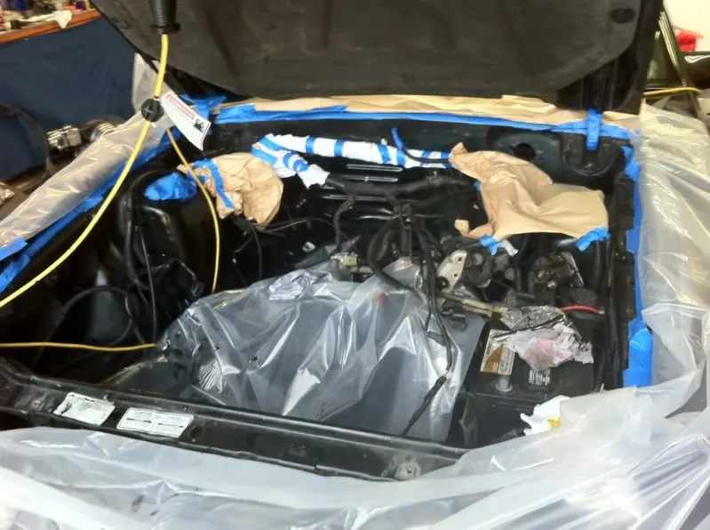

More pics.
Before paint, we sprayed a little on the left side of this picture to test that's why it's black. Also sprayed a little on the left side of the firewall. We were still prepping the bay. Battery and tray still in there.
Removal of the battery and tray revealed more green and grime.

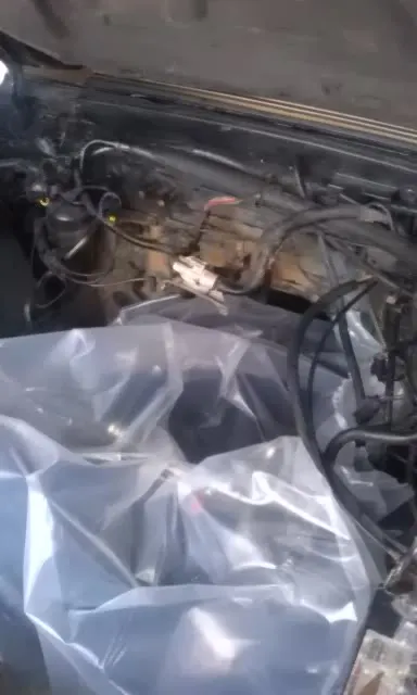

Took all the sensors off the fender-MAF and smog crap.

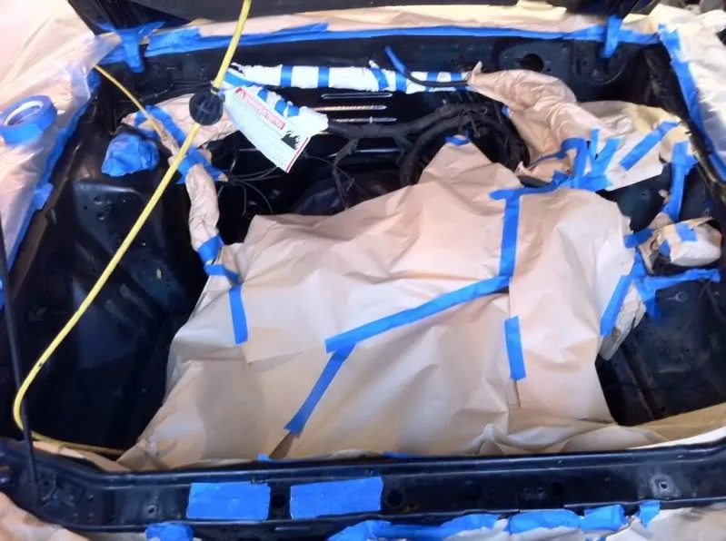

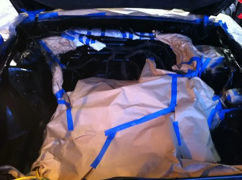

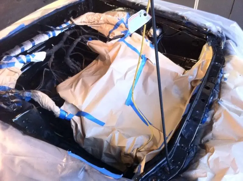

Getting ready to spray.
After, it got dark. I'll take a picture when I get home today and post in the light.

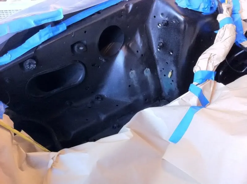

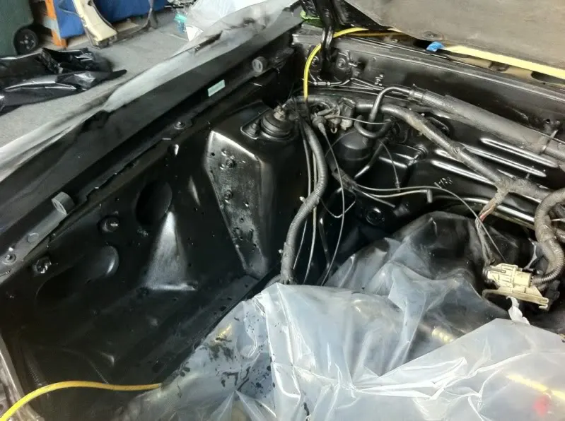

Well here is the picture with engine bay all black.

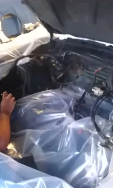

The hiding of the wires have started. The passenger side is finished. Only wire over there is for the MAF.

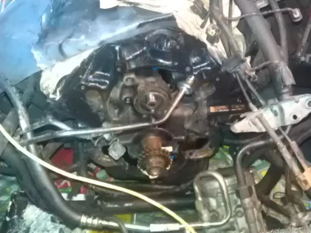

Also cleaned the block in the timing cover / water pump area. Also painted the block.
Goals for tonight. I don't like how blotchy the passenger side paint came out. Now that the wires are hidden that needs to look better. Going to sand that and repsray the section. More wires hidden into the fenders. That's all for tonight.
