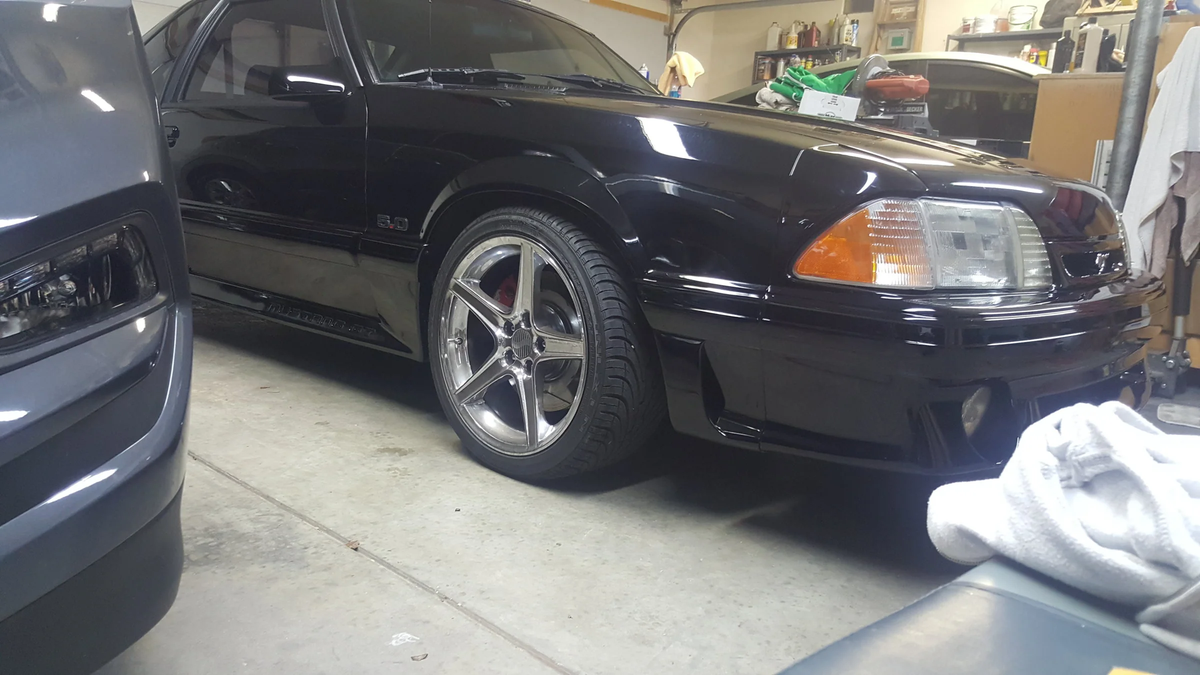

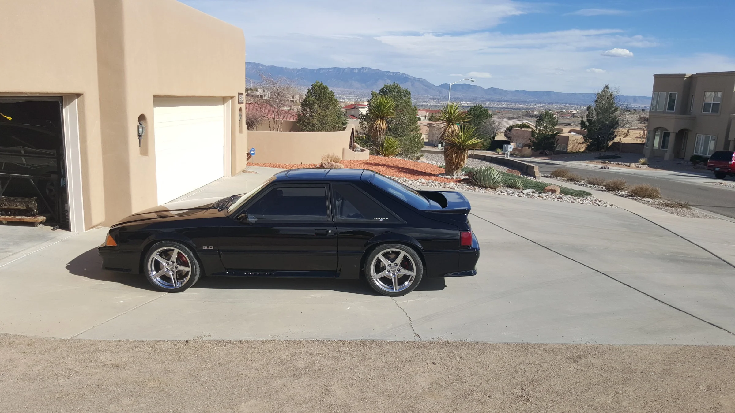

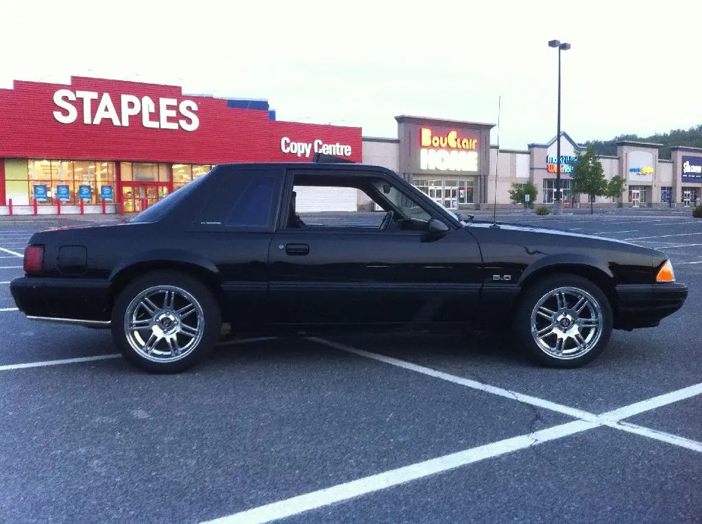

You know my .02 worth lol. I run same wheel tire combo as yours. Here's a pick when I screwed it up(fan ran into radiator etc) also had front as low as it would go. I intend to raise it 1/4-1/2" but I have clearance on everything as is.

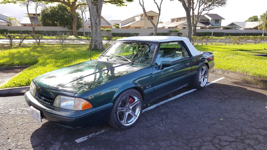

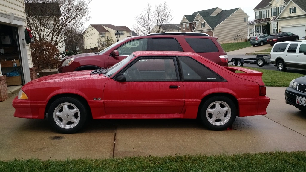

Stock front springs, with 2/3 of a coil removed and stock, 25-rear-old read springs out back, sitting on top of a set of polyurethane isolators. Car sits the way I want it to and rides every bit as well as it did stock.
No need for aftermarket springs if all you want to do is drop the stance a little.

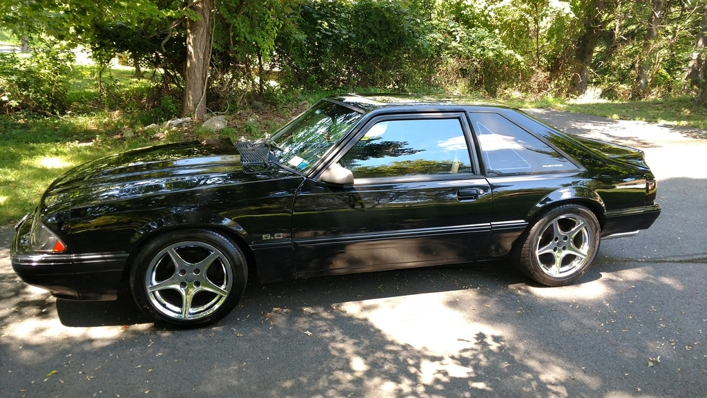

03/04 Mach 1 springs

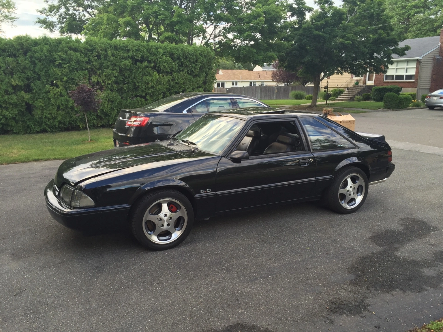

Didn't want to be slammed anymore, but didn't want the sloppy handling of stock springs. I have MM weigh jacker control arms out back, so I may trim 1/2 coil up front and lower the rear a tad. I can lower the rear so that the rear tire begins to tuck into the fender.
With tokiko Blues, it rides pretty nice without the teeth chattering over big bumps. The springs are 600# linear rate, so it still handles well.
I like it, but I wouldn't mind 1/2" lower or so.

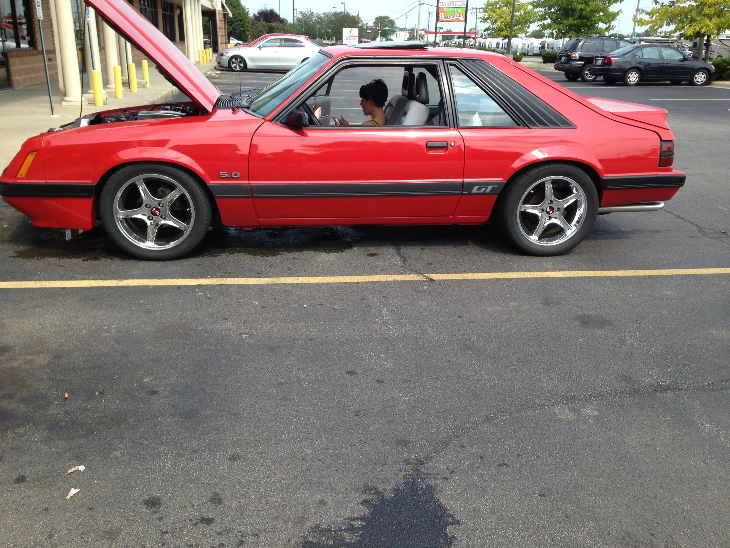

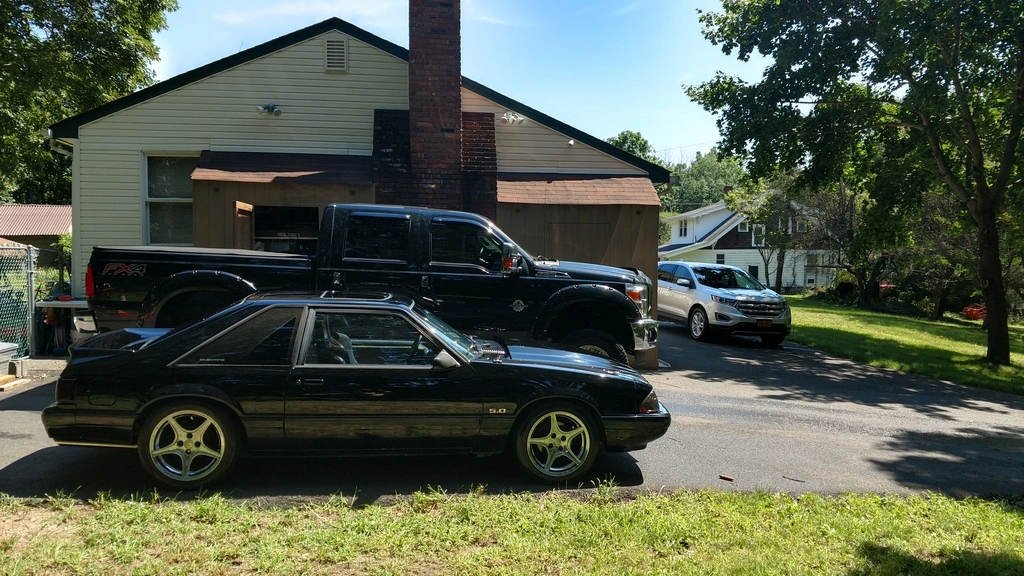

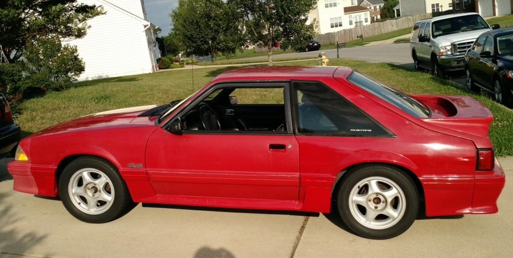

running the eibach sports i believe with KYB shocks(installed by PO) 245/45 fronts with 275/40 rears rubs full lock in the front and on big bumps in the back. i got 9" wheels all the way around and im not sure of the offset. wheels were also installed by PO and i can find any info on them online

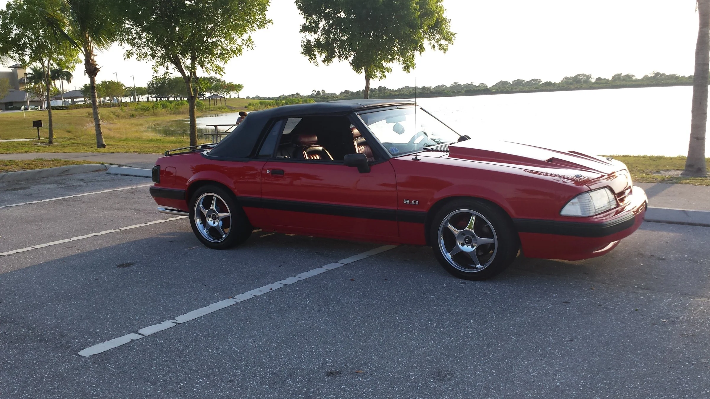

This will not be as easy a choice as I thought it was gonna be, all of the pics you guys have posted look great, I would be quite happy with any of the above stances, and I'll tell ya what, If I ever get around to a 5 lug conversion 18" wheels are gonna be in my future.
