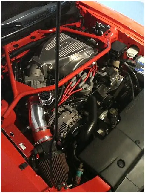

The Holley does clear the stock hood. I was suprised as well.
