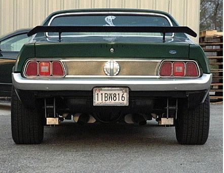

WHat do you guys think of this for 72' 351c?
