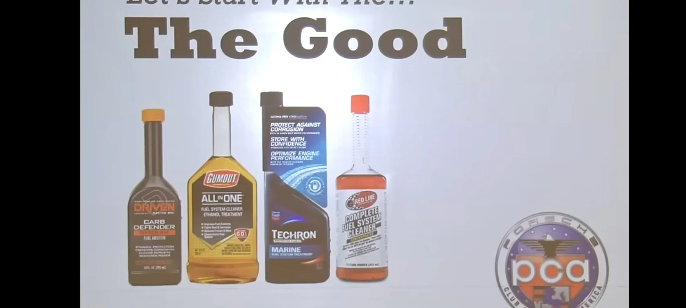

He also suggests only one additive for fuels and none for oils. If you're not using "tier 1 fuels" already, then no brand in particular, but specifically PAE (poly-ethyl amine, I believe) works best to keep injectors clean. I noticed oil getting through the PCV in black jack and buildup on the backs of some valves, and I think I'll pick some up and run it for a while to hopefully clean up the valves and combustion chambers a bit.
