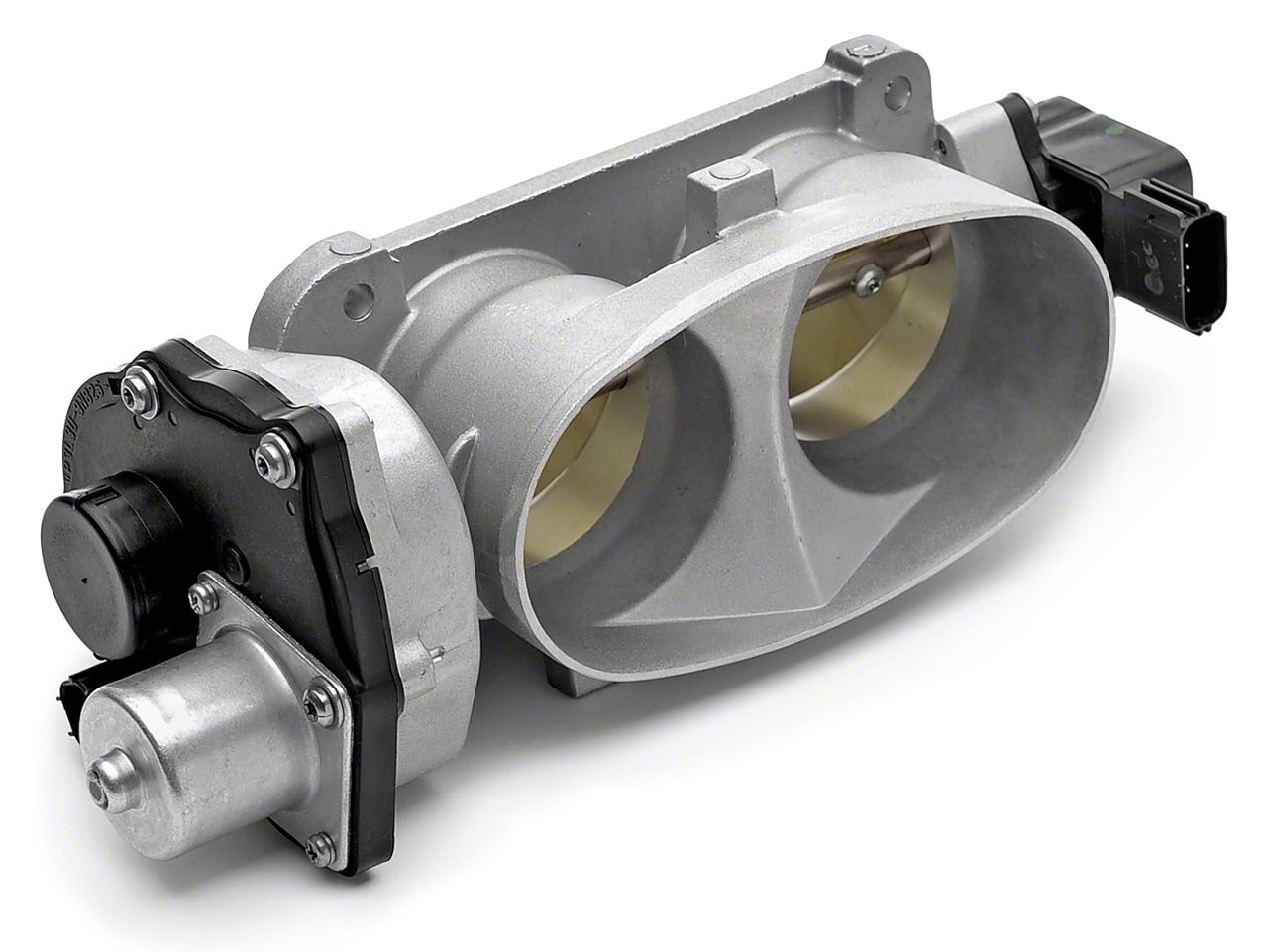

Granatelli, T. Body, 62mm,x(2) a Bolt on, all new Hardware Sensors installed, 15HP increase by itself- 400$ (SR is much cheaper, don’t trust them quite yet, others love their parts).

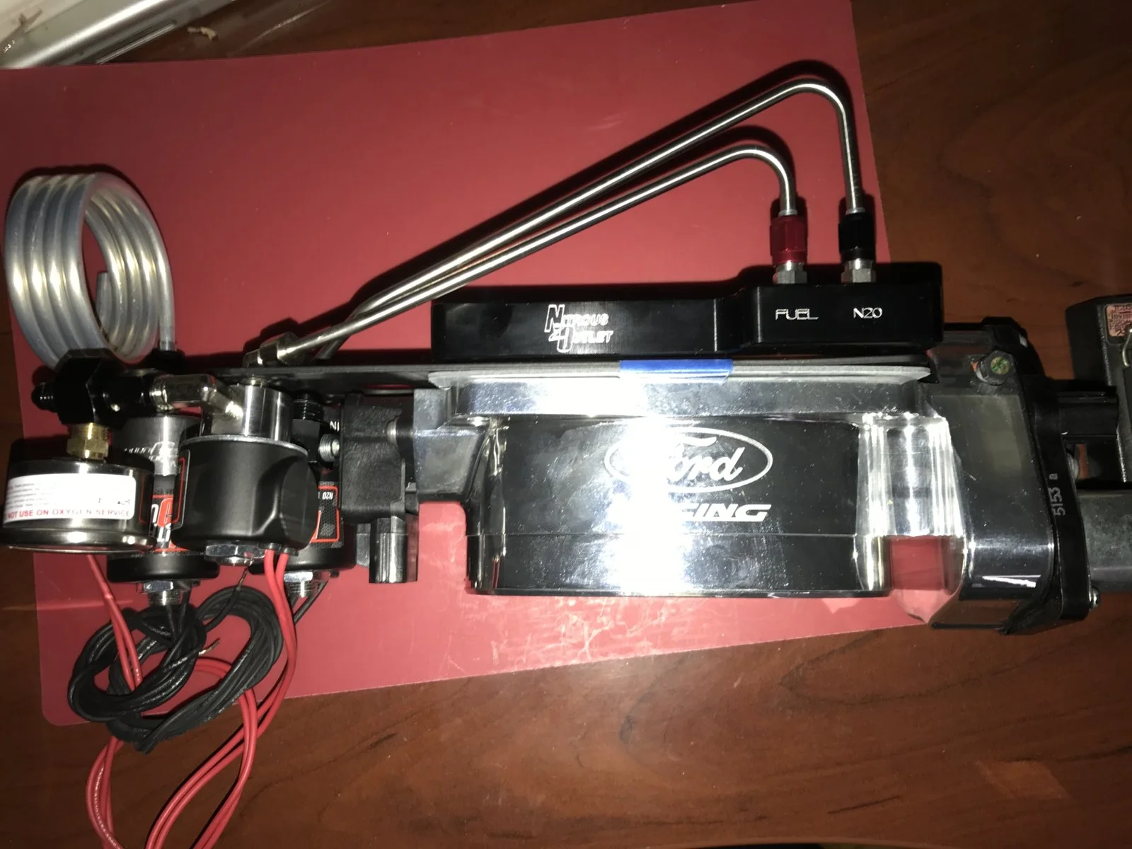

Hardline Plate WET NOS System, since the Dyno, I tweak it on the side of the road, IT’S my Dyno, for now..

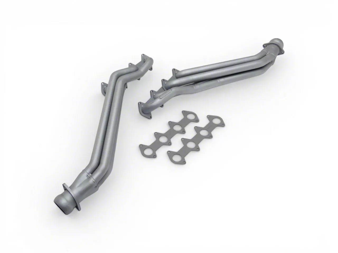

KOOKS L.T. 1-5/8” 304S.S. Headers w/Catted X Pipe. 1,200$. Note: Ceramic coated BBK L.T.’s can be bought for around 500$, and work well. I’d wrap them with titanium wrap.
I opt for 304 Stainless, super thick flanges, excellent TIG weld quality. & fit.
BBK 1-5/8”: 500$

-John. My T/B & NOS
