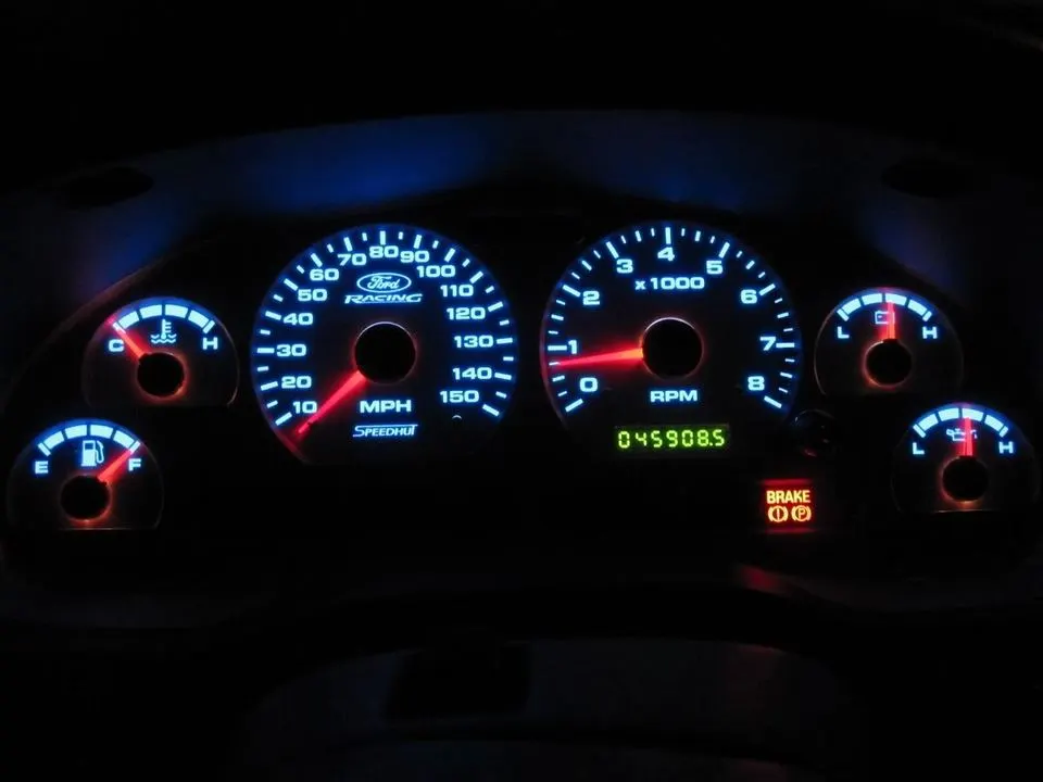

Thinking about getting a shift light before going to the track because I can't see redline in the dark with the Speedhut gauges. Only the numbers and hash marks light up blue.

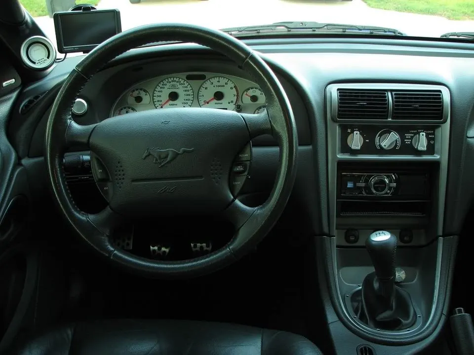

Yeah I like it being in the A/C vent. Plus when people ride with you and all of the sudden see your A/C vent light up, then you shift, then it lights up again and you shift, it get's pretty funny. All my friends were like "WTF is that?"
You always drive at redline with friends in the car? ;) Where do you run the wire out of the AC vent? I'd really like to see this setup. Just bend it around and come back out near the front of the shift light? Then down and under the radio?
Easy to see out of your peripheral vision? Is it bright at night since you can't really take the cap on and off?

Haha, usually when someone rides in the car that hasnt rode in it w/ me spraying, they end up talking me into spraying it.
I set mine up just like the person did in that link above. You can see it very easily out of your peripheral vision and can still see it easily during the day time.
