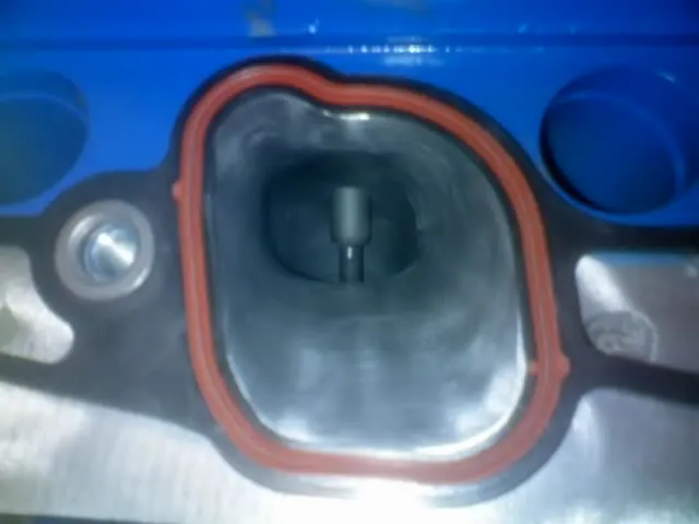

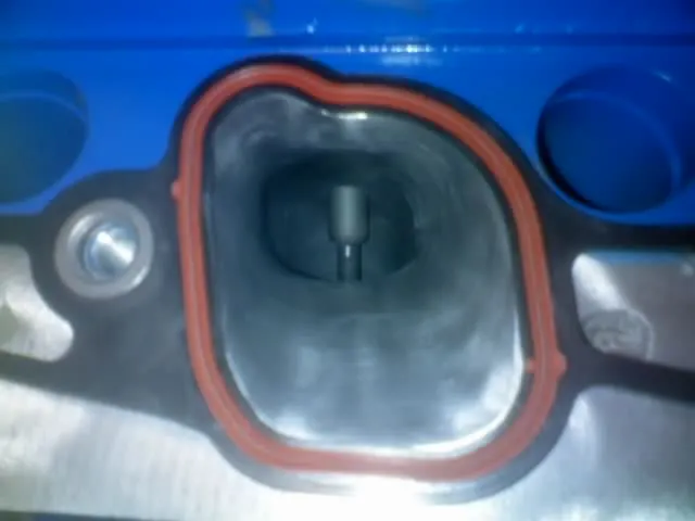

heres a pic on the intake port ported, and pi port matched to go with the pi intake, there about all about 170cc's, i couldnt get a good pic of the exhaust ports...

That's only in certain ranges of the lift schedule, and that's which machining the combustion chambers, often CNC'd. And port matching.
