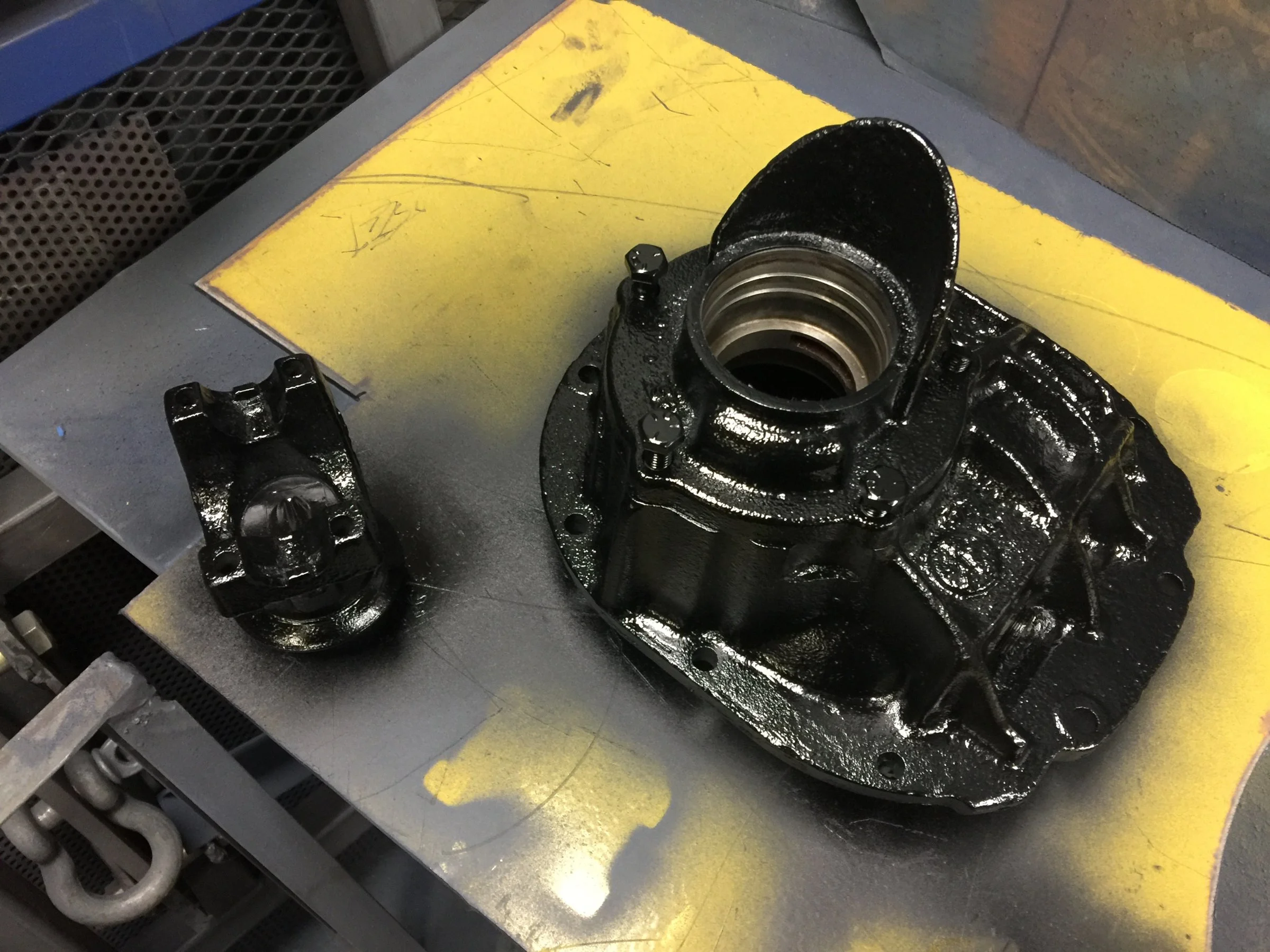

I took my spare diff apart yesterday and I am repainting it getting rdy to put it back together. I am missing the torque spec for the nut that screws on the end of the pinion shaft.
Could you help me out pls.
There's no torque spec on the pinion nut, it's typically several hundred lb-ft to crush the crush sleeve until there is slight drag (inch-pounds) on the rotating assembly. If you've disassembled, you have to mark the exact location of the nut and return it to that place, or a new crush sleeve is needed (better), or a spacer and shim set which I like the best.

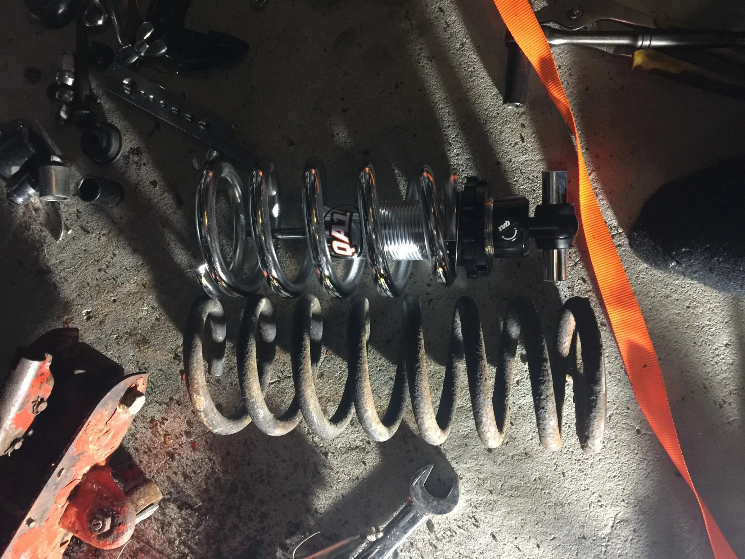

Just finished installing the first coil over. It is a PITA to install. I'm sure there is a spring compressor out there that would help grately.
The ride hight is actually higher by 1/2 an inch with it screwed down as low as I would go. The nut on the shocks that adjusts the hight hits the lower swing arm if you hit a huge bump right now. (If the car were to lift up in the air I mean). In other words if I jack up the car off it's wheels, it touches. From the top of my fender to the ground is 22 3/4 inch. It might change a little bit when I do the other side tho.
This kit was clearly made for a chevy and modified to fit the 2. The pictures in the instructions show how to install it in a chevy. Wich btw looks like a much easier install.
With the shocks adjusted to 0, the is little difference between the left and right side. With the shock adjusted to 8, it feels more like what I was expecting, (approx twice to three times as stiff).
