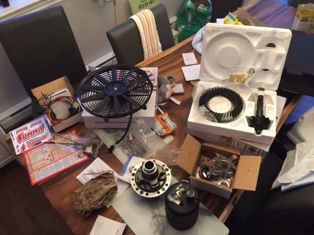

I'm about to order the true trac locker differential. I have a spear differential, so I can start assembling / rebuilding it right away.
Here are the parts I plan on ordering with it:
https://www.summitracing.com/int/parts/rat-358k
https://www.summitracing.com/int/parts/sum-740801
https://www.summitracing.com/int/parts/sum-730001
Anything else I should order? I have to pay shipping to Canada, so I want everything in one box.

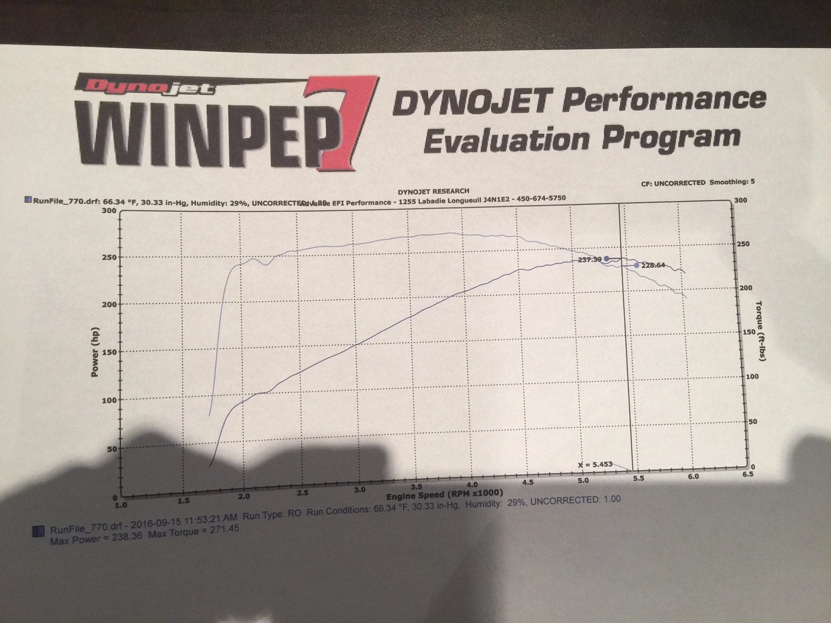

Thats pretty much all I can stomach for this winter $$ wise. I'll probably try and dyno it this weekend to have an idea of what it's like now.

As for your shopping list, I think that includes everything except lube. Be sure you have a dial indicator, a depth micrometer would be a great idea, and if memory serves you will probably need something to measure your depth from that spans the overall distance of the housing for the depth mic. This is for setting your pinion depth. You will need either a crush sleeve or a spacer as was mentioned earlier to tighten the yoke to spec. Again, if memory serves, either the 9" or 8.8 crush sleeves work for the 8". I may be totally wrong, it's been a few years and a head injury since I've tackled mine. :) But if you go by the article that I linked to before, you shouldn't have any problems getting it done.

Or the dyno calibrator did something wrong. :-( Seriously that's a nice flat torque curve that comes on fast. Pretty nice power at the wheels. Since you were considering bolt-ons earlier, and long-tubes, I think you'll only mess with the fairly impressive power and nice curve you're making now and maybe even go backwards.
The combo you have now is pretty solid, or you have a stroker already, to be putting down those numbers (especially if those are stock heads). Me, personally, I'd leave well enough alone considering what you now know. Or go forced induction if you're looking for serious gains.
