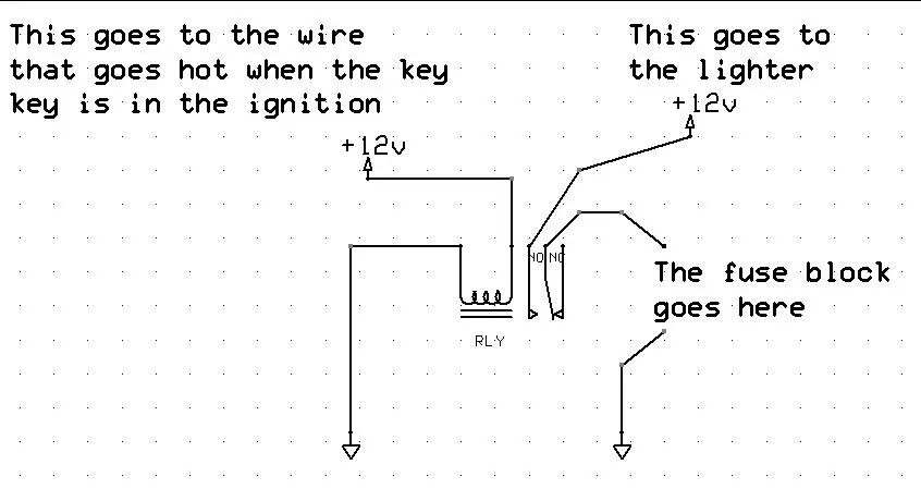

Whats a good power source nearby the passenger side kick panel?
Right now, I have my wideband, fuel pressure/boost gauges, radar detector, white face guages and probably more all wired to a fuse in my fusebox. Its pretty ghetto, the power wire is jammed up in there but it works. I bought a fuse block from Advance, and now I want to do it right. Where should I get the power from under there? It needs to be an source thats turns on when ignition is on.
like this ...
91LX_5L said:
Pull out your heating/ac controls, take out the screws then splice into the back of one of the 12v ignition powered wires that go to them. Simple and clean.
that works too but is it fused, and if so, what is the amperage of the fuse and will it blow if you have it all going at the same time?
