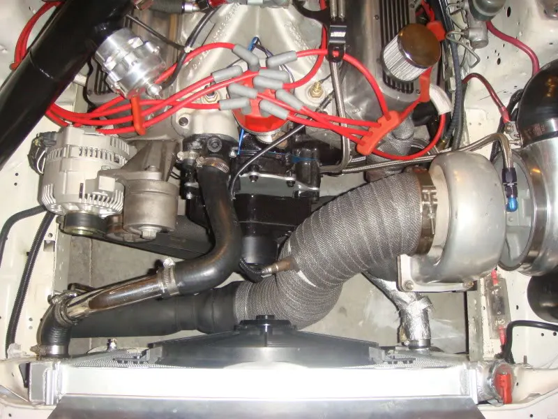

TokyoJoe, what all do you have done with your engine? What is your cooling system like? Do you have an opening in your grill? i.e. Cobra Grille Insert or LX bumper.
EDIT: Also do you have A/C??? I have a A/C condenser in front of my radiator.

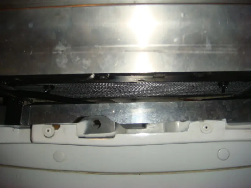

If it was fan problem then cruising 50+ mph on the highway should keep the car cool. Is the scrape guard still on the car? It actually redirects air towards the radiator.

3. Check to ensure that stock vents are still in place. Air scoops/brush guards usually help to push air through the radiator at speed. A GT without the hole that leads to the radiator is more susceptible to overheating without the front air dam/scrape guard.

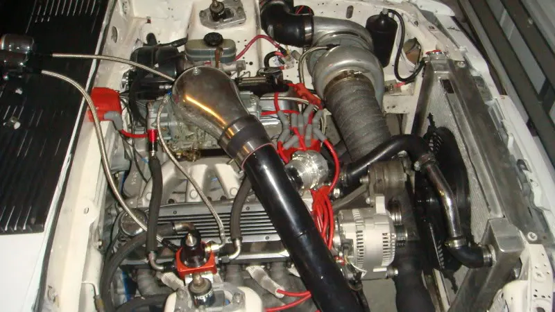

I don't know about Joe, but I have an A/C condenser and an intercooler in front of my radiator. I had cooling problems and decided to get a new radiator, condenser, and a badass set of electric cooling fans to fix my problem. I think my problem was the ability to draw air through at idle. I don't think that the one spal fan I had was enough. So, I got another one, and now my car is happy again!:nice:
Scrapeguard is the black plastic thing that goes straight down about 3" or so at the radiator cross member.
My cooling system is the same 3 row radiator that you have with a massive 4" intercooler with about a 4" gab between my radiator. I have an 18" slimline fan with a 5" downpipe about 1/2" in front of it with an electric water pump. Runs 180* with the fan on a 180* relay.
