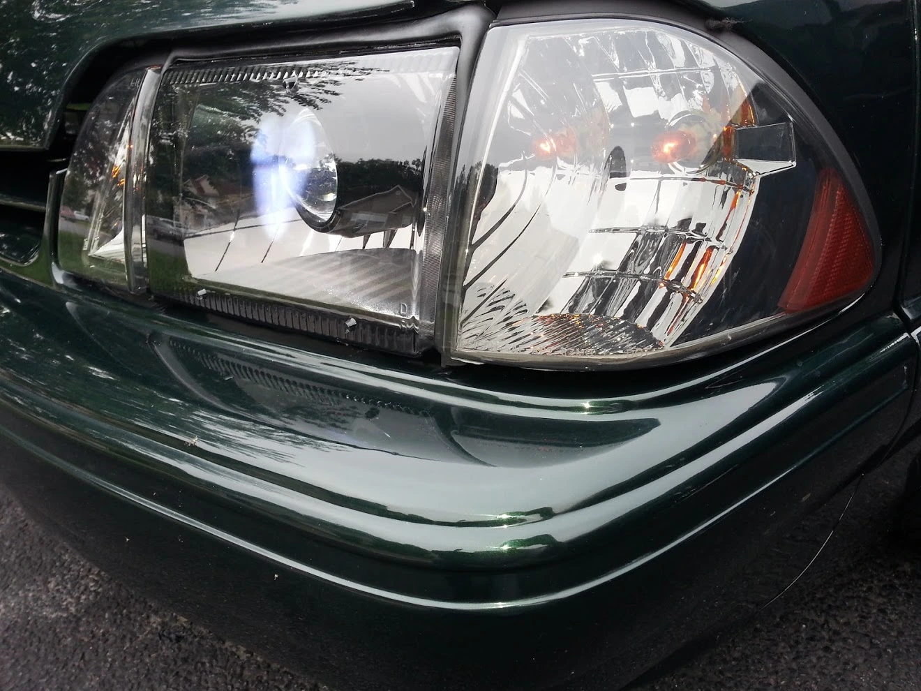

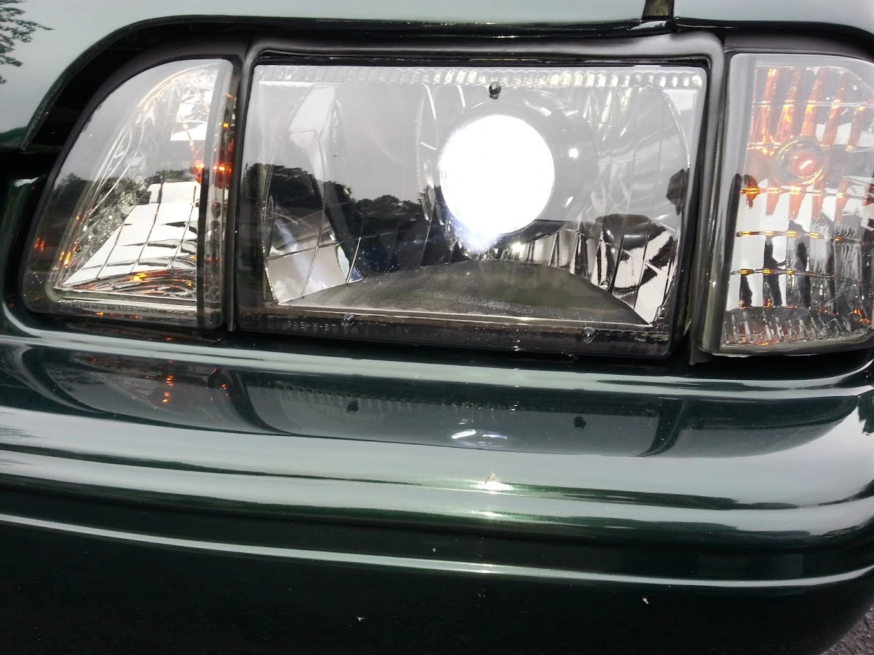

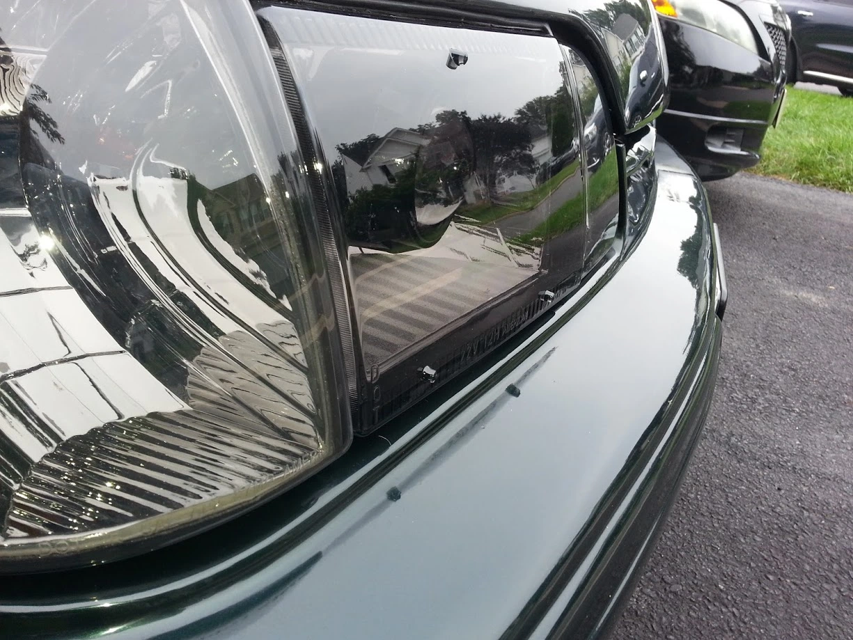

I have done a Morimoto retrofit on my fox, the light output was great with HIDs and it definitely helped my fox stand out in a crowd. I didn't like all the extra wires and harnesses associated with retrofit to HIDs and "behind the scene" was hard to clean up and looked messy to me. I have reverted back to an led bulb in each new globe for simplicity. I may revisit these headlights in the future but its not cheap nor is it easy to duplicate

This is what I want to do . Use the ultra smoke center only though as I’m not a fan of the markers and like the stock fluted look . I know the factory fluted lense is no good for a projector though.

LED or HID do not belong in a housing meant for halogen bulbs unless you do a proper retrofit, with a NON-fluted lense. Period.
Reflector housings scatter the light all around in the first place. LED and or HID is just a brighter light scatter. Put a goddamn retrofit projector in a NON-fluted housing or leave it the phuck alone.

It was just so much tedious work to get them right. I told myself that I will no longer put that much time into seeing at night. I don't even drive at night most time! Ultra clear is the way to go as I tried both, definitely better results with the clear. Did I mention the cost :eek:? Good luck!
