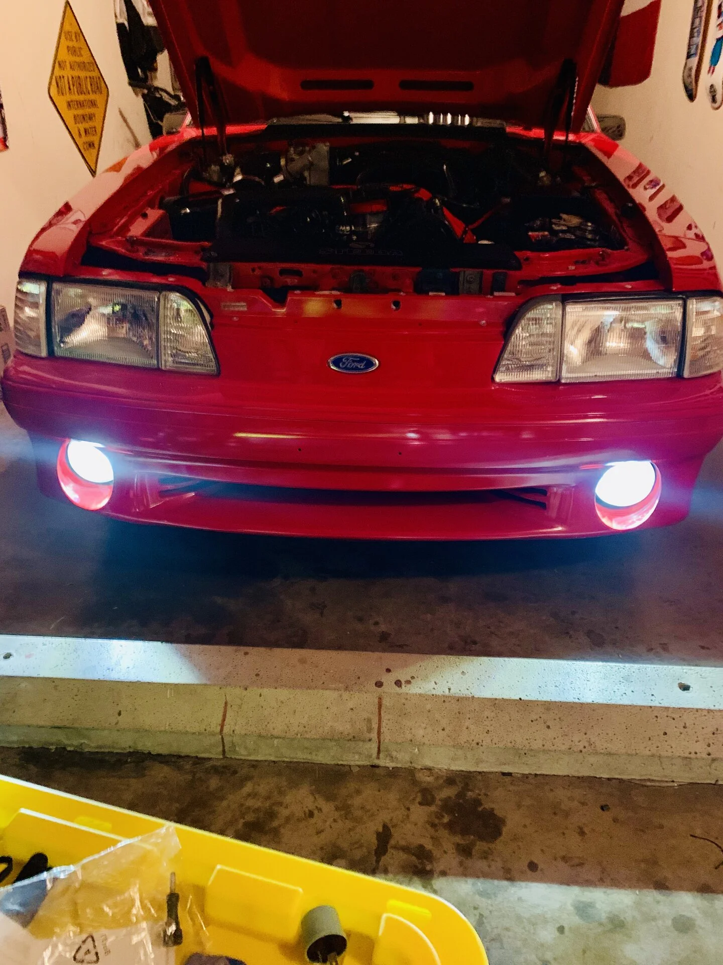

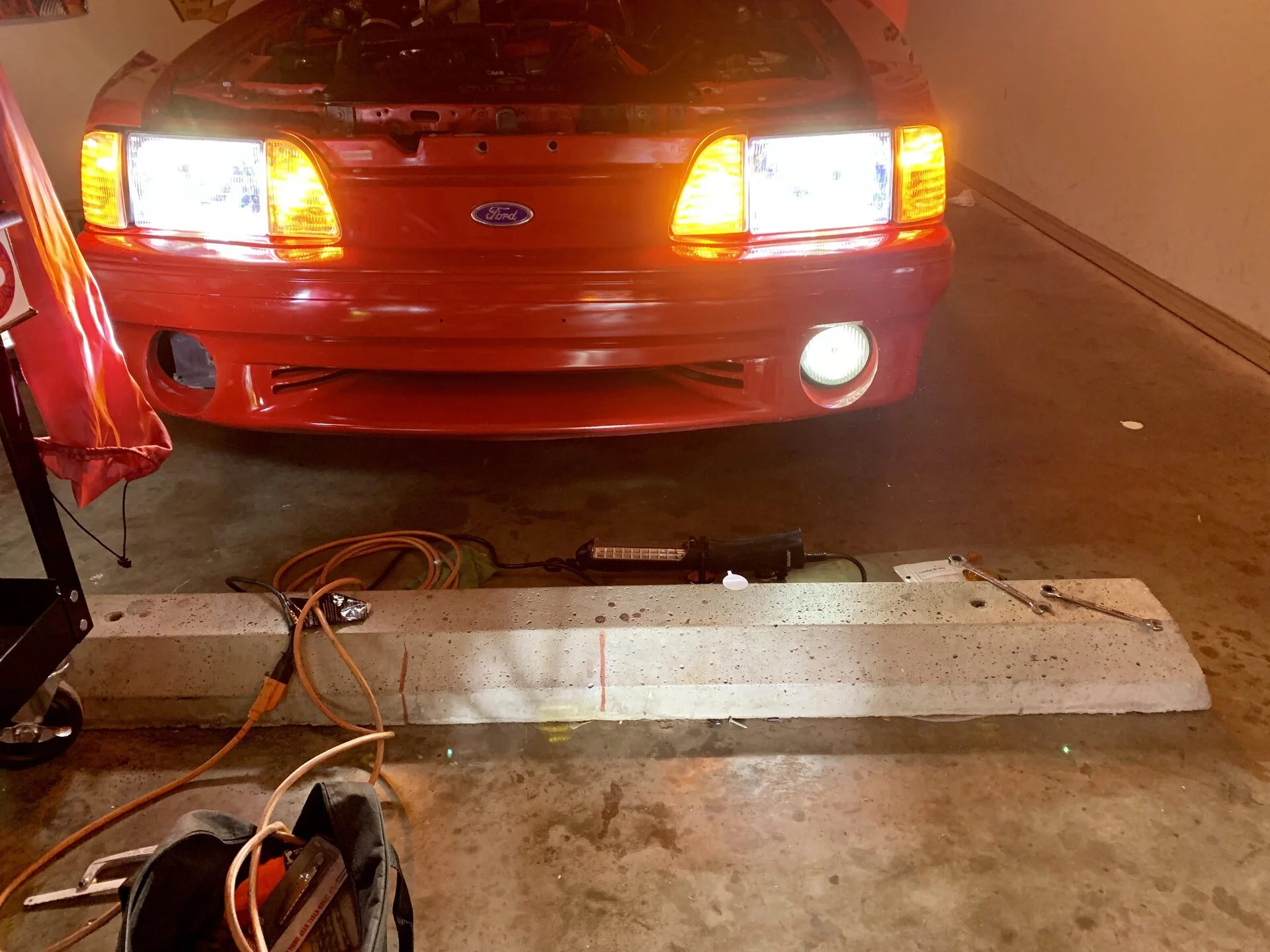

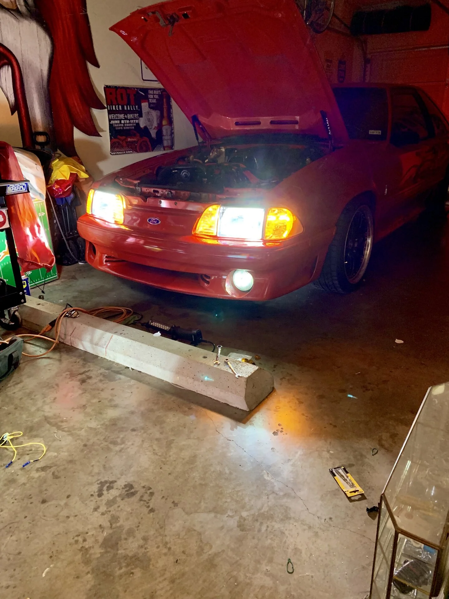

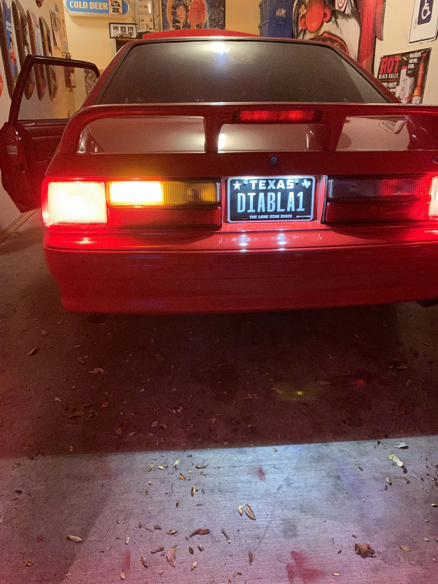

I recently converted all lights on the car inside and out with led bulbs. I even did the dash bulbs. They all are definitely a bit brighter than factory but I think its all just preference for looks and likes. Hey, what else do we invest in this hobby for?
I like mine!! But I never drive it at night so they never come on. Went LED crazy and it messed with my blinkers and flashers had it fixed but now they are messed up again. So I do the manual blinker by just moving the lever lol

Reddevils brake lights seem much brighter. I have them all over the inside and love them. Makes the dash light up bright. Not messin with the exterior. Too expensive and I dont drive at night that much.

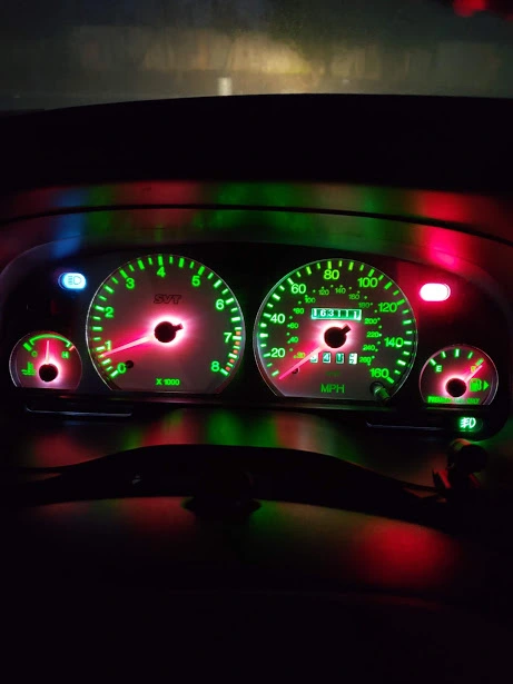

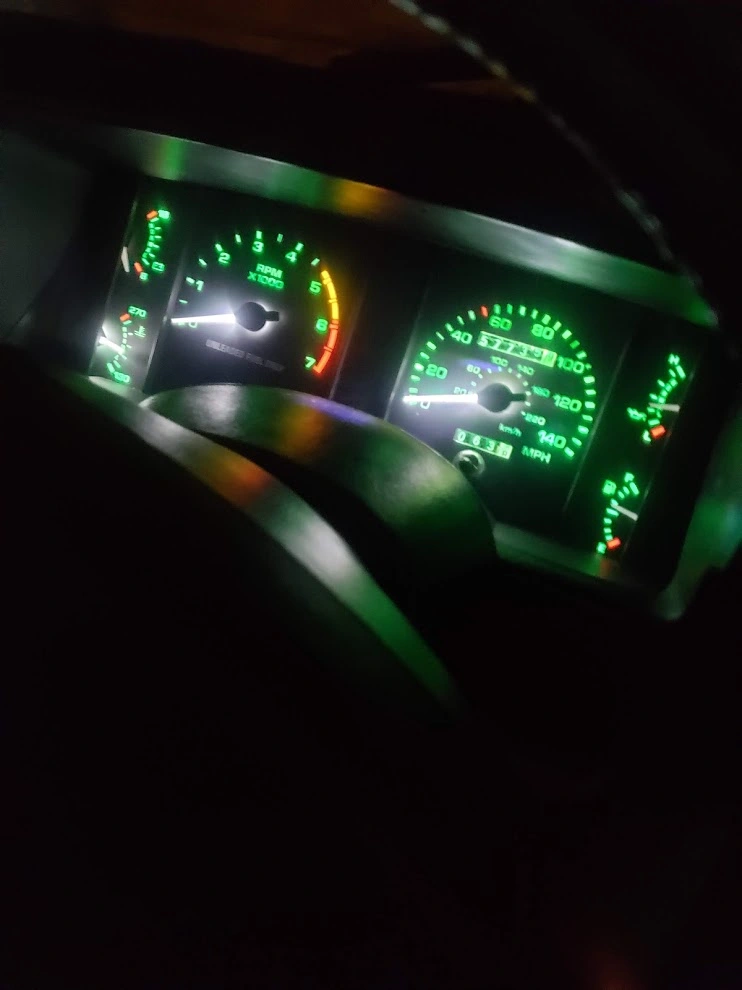

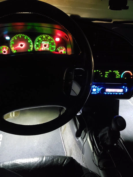

My SVT Contour when I converted the dash bulbs to LED. The green from the stock cluster and needles are more pronounced. My Fox dash looks the same.
