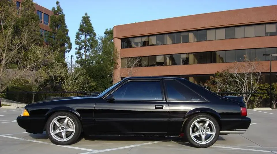

UPDATE:
I painted the wheels using VHT Ford Argent silver wheel paint and their clear coat. Turned out nice, I will get pics up soon. I painted the rims with no tires on them and when the shop put the new tires on there wasn't a single scratch/chip in the paint. With good prep the VHT stuff bonds well. Also I got the best deal on the paint from Amazon, in total I used 3 cans of silver and about 2 cans of clear.
the 98 Cobras are spray bombed :) I painted and had tires mounted the same day, not perfect but pretty good.
