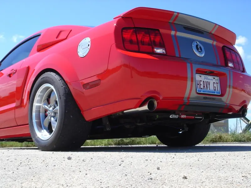

I have used the Nittos 555 DR 305/45/18's in the rear and now run the Mickey Thompson ET Streets in the same size.
You can go up to a 305 depending on your aspect ratio and wheel size. This is only good though if you are running a Watts's Link such as the Saleen. If you run a panhard bar then the Drivers side will rub on the inner fender well and the pass side will rub n the outer fender lip. This however, depends on if you are lowered as well...
