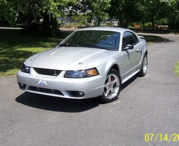

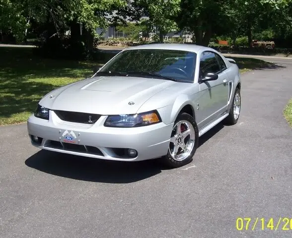

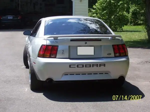

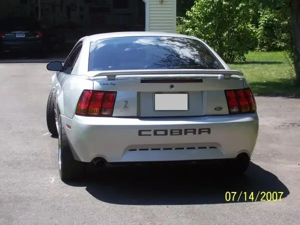

I put 1.25" spacers on my '01 Cobra. Here's some pics. It's in the garage now getting it's H&R Sports put on so no comments on the 4x4 look :)
