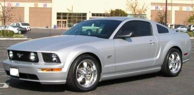

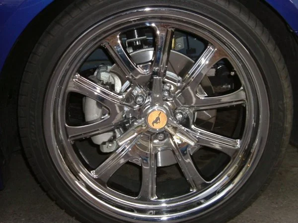

gp001 said:
OK Members, I am testing out the usefullness of doing FAQs for the S197 Tech Section. I am going to start with one for wheels/tires. If it proves sucessfull I will move on to other areas.
What I need from all of you with NON STOCK wheels is:
Wheels:
Brand BLINGZ
Model GHOST GT
Wheel Diameter F 20X8.5 R 20X10
Offset F +30 R +37
Did you need/use a spacer? NOPE
Tires:
Brand HANKOOK
Model K104
Size F 255/35-20 R 275/35-20
Suspension Mods if any:Eibach Pro-Kit Spring Set,Eibach Anti-Roll Kit
A picture. Preferably small. Can also be a link if A) it is your car, and B) you have the right to link to that webspace.
The only information I want in replies to this thread is the info above. No "Where'd you buy those", "Those look great", etc. Use PMs or e-mail for that.

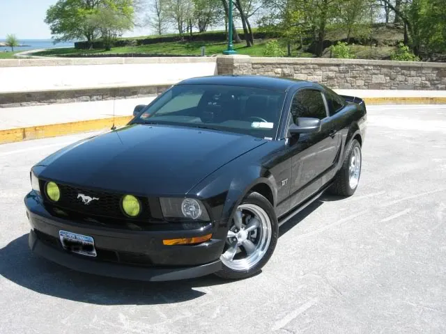

Wheels:
Brand: Boyd Coddington
Model: Smoothie II high polished
Wheel Diameter: 18" x 9"
Offset: don't know, I took what they said was the right offset for the 05 GT. they swore it was right and it was. tires are right at the edge of fender.
Tires:
Brand: Pirelli
Model: P-Zero Nero
Size: P275/40-18 all four corners
Suspension Mods if any: Steeda lowering coils, approx 1-1/2" drop.
A picture.
http://forums.stangnet.com/attachment.php?attachmentid=44592&stc=1&d=1147460432

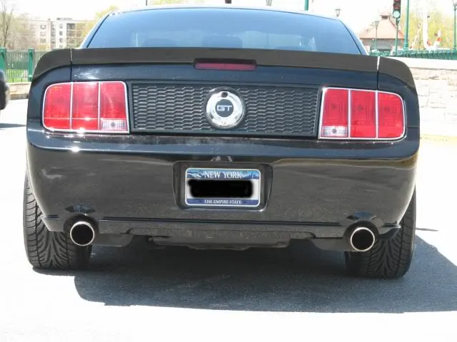

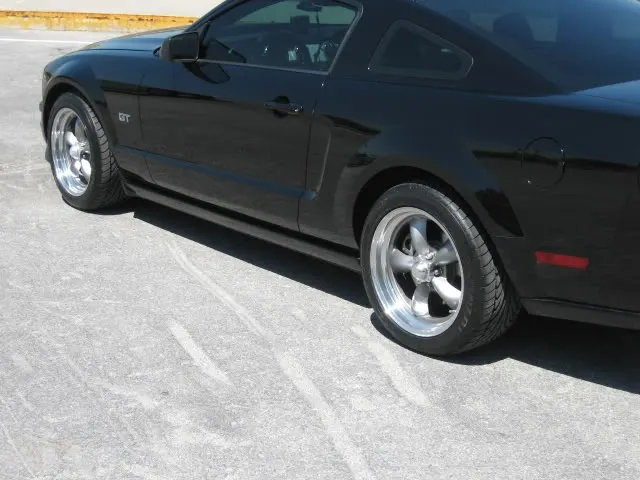

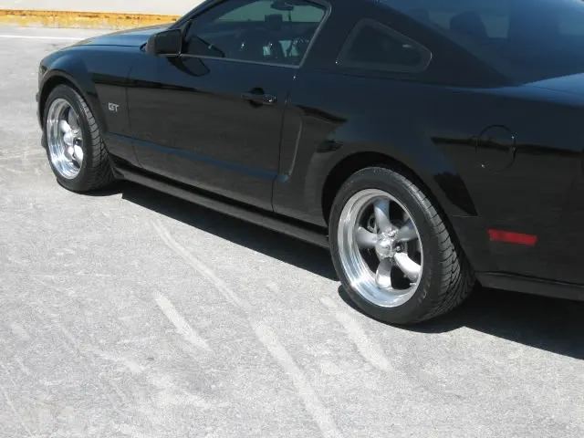

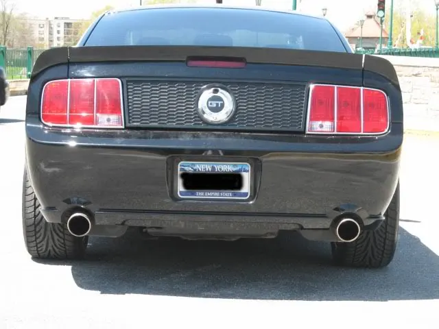

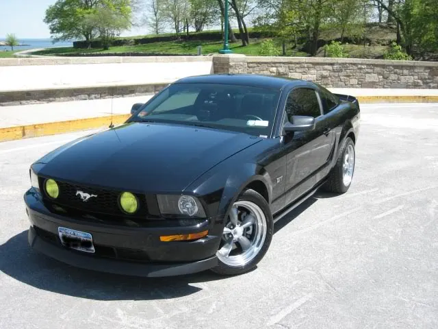

wheels
Brand: american racing
Model: torq thrust II
Wheel Diameter: 18x10 front and back
Offset: 7.25" backspace same for front and back
Did you need/use a spacer? nope
tires
Brand: dunlop
Model: 9000
stocked out suspension

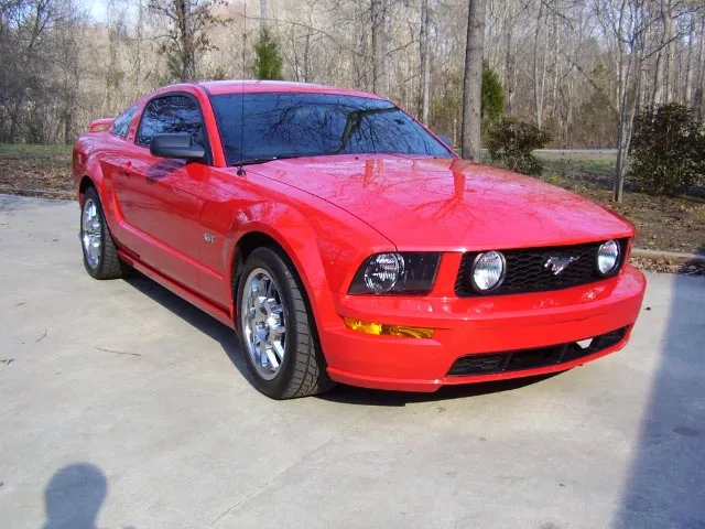

Wheels:
Brand -- OE
Model -- 2007 Cobra Replica
Wheel Diameter -- Front:17X9 Rear: 18X10
Offset -- Unknown, But look okay to me
Did you need/use a spacer? No
Tires:
Brand Nitto
Model Extreme 555ZR
Size Front:255-45-17
Rear :275-40-18
Suspension Mods if any :None
