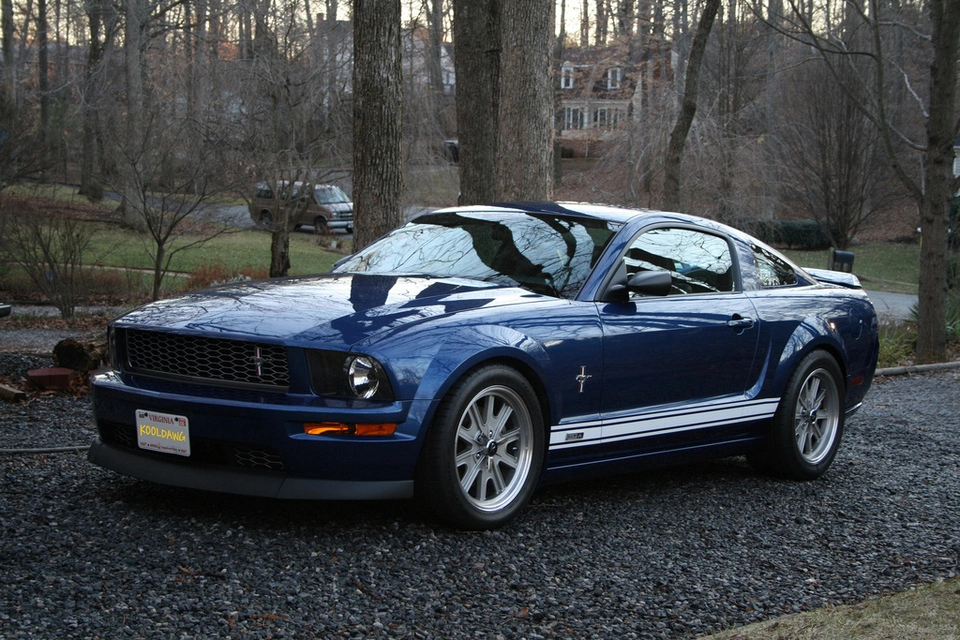

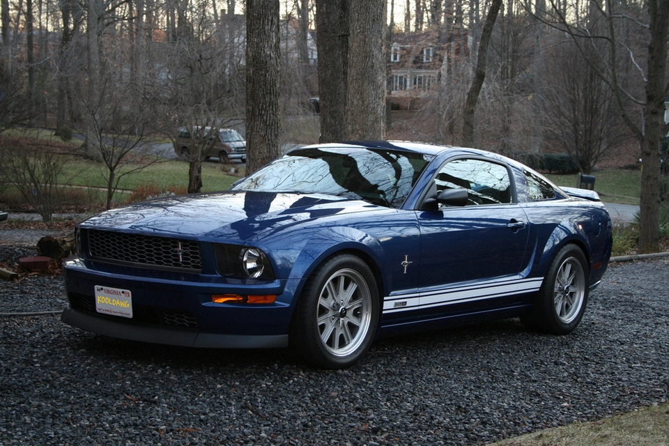

Wheels: 18' X10 rear X 9 front
Brand Mustang Tuning
Model DD Bullets chrome
Wheel 18 Diameter
Offset 45---34
Did you need/use a spacer? Yes .180 thick
Tires:
Brand Nitto
Model DR rear 555 front
Size 305/45/18 rear 265/45/18 front

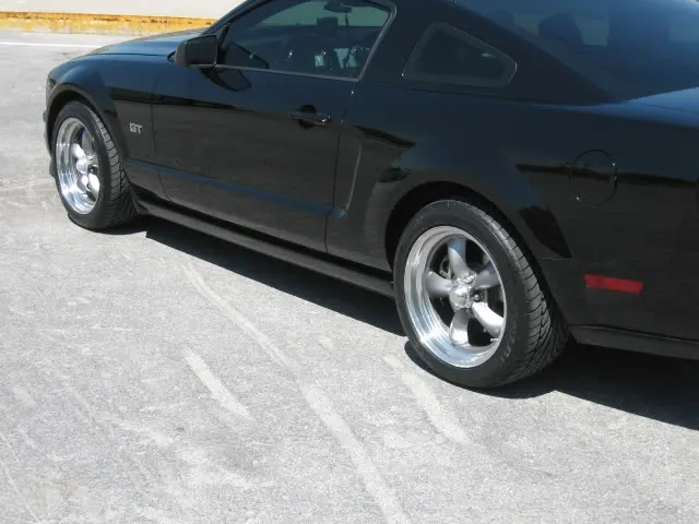

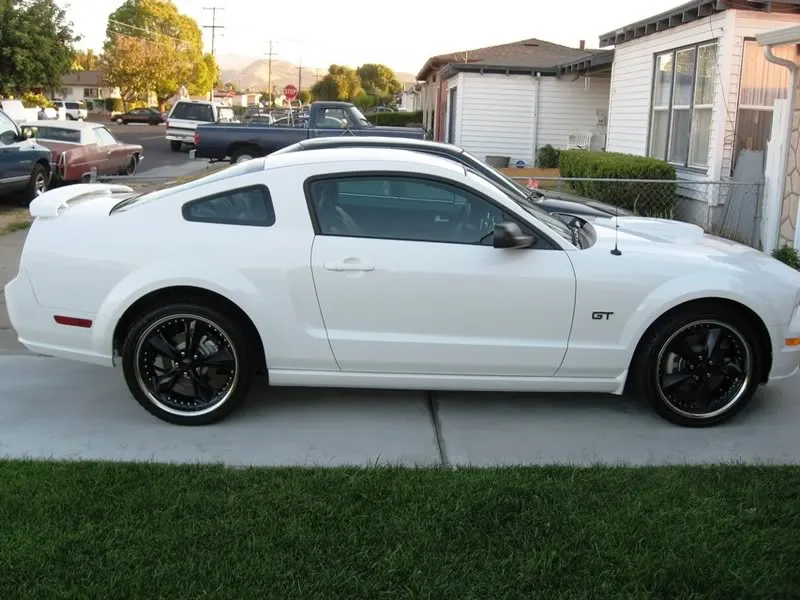

Wheels:
Brand - Foose
Model - Nitrous Chrome
Wheel - 18x8.5
Offset - +34mm
Did you need/use a spacer? No
Tires:
Brand - BF Goodrich
Model - KDW 2
Size - 235/55/18
I bought these at www.cruisinchrome.com - great customer service and very helpful. I originally ordered 2- 18x8.5's and 2-18x10's The 18x10 wheels he sent me didn't have the right offset. He paid the shipping both ways to get them right. I will buy my next set of wheels from them again!!! Call the 909-6289763 (Cali number) and ask for Bill -- Tell him Larry from Denver sent you. You will not be disappointed
<img src="http://www.boyces.net/foose2.jpg" border="0" alt="" /><br />
<img src="http://www.boyces.net/foose3.jpg" border="0" alt="" /><br />

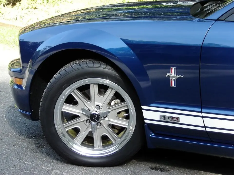

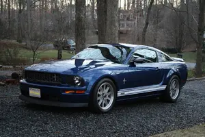

Wheels:
Brand - Rev Wheel
Model - Cobra 340 Gunmetal
Wheel Diameter(Front)- 18X8.5
Offset - +32
Wheel Diameter(Rear)- 18x10
Offset- +45
Did you need/use a spacer? No.
Tires:
Brand -Nitto
Model - NT555
Size - 255/45ZR18(Front)
295/45ZR18(Rear)
All stock suspension
Now have StangSuspension Series II springs(1.75" front& 1.5" rear), Steeda heavy duty upper strut mounts and Steeda adjustable panhard bar.
NO tire rub of any kind, but the CDC Classic spoiler scrapes a few times/week.

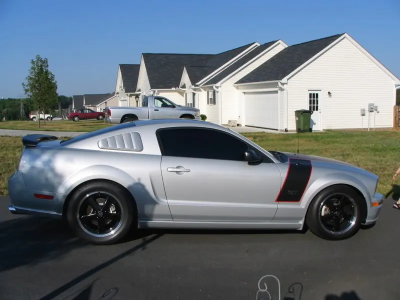

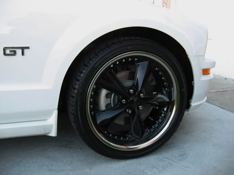

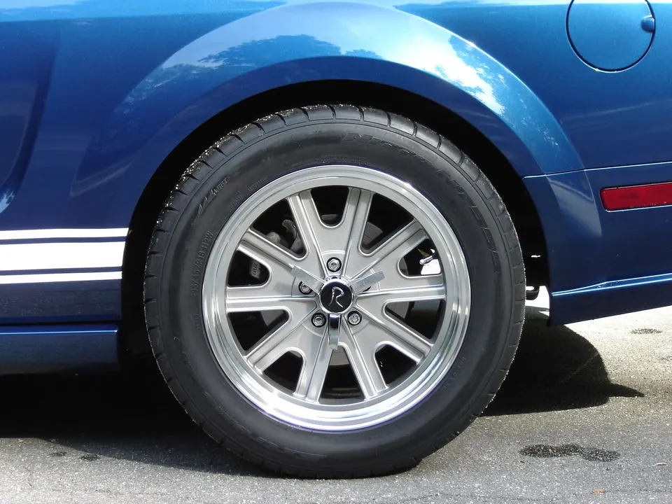

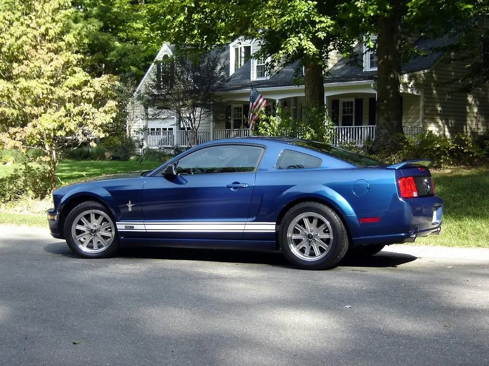

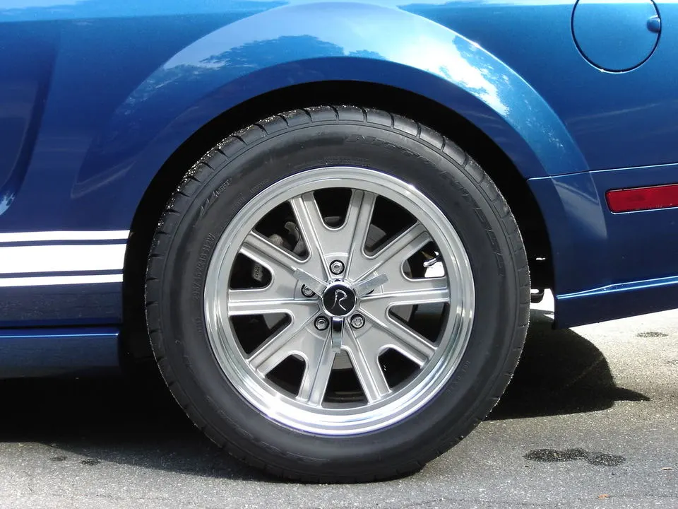

Wheels
Brand: Foose
Model: Nitrous
Wheel Diameter: 20"x8.5"
Offset: not sure
Tires
Brand: Nexen
Model: N3000
Suspension Mods? None, but just planning on FRPP K Springs
Now 2 quick questions:
What is the widest tire I can use on this rim? I'm guessing 295 but not sure.
And I have a set of (2) 17" 96-97 Cobra rims. I am wanting to slap on some Mickey Thompson ET streets size 275/40-17s but I am not sure if the actual rim will work on my car. Will that rim and tire combo fit?
