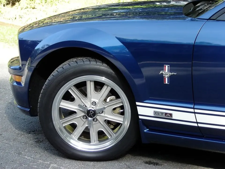

Wheels:
Rota
Tarmac III
18x8
35mm Offset
Did you need/use a spacer? Nope. This rim isn't hubcentric to mustang though; 73mm versus 70.5 for Mustang. No problem so far, even with auto-x.
Tires:
Kumho
Ecsta SPT
235/50R18
Suspension Mods if any
Koni Struts, Panhard bar, LCAs

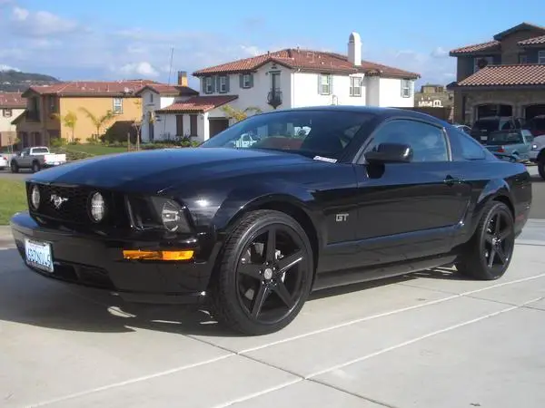

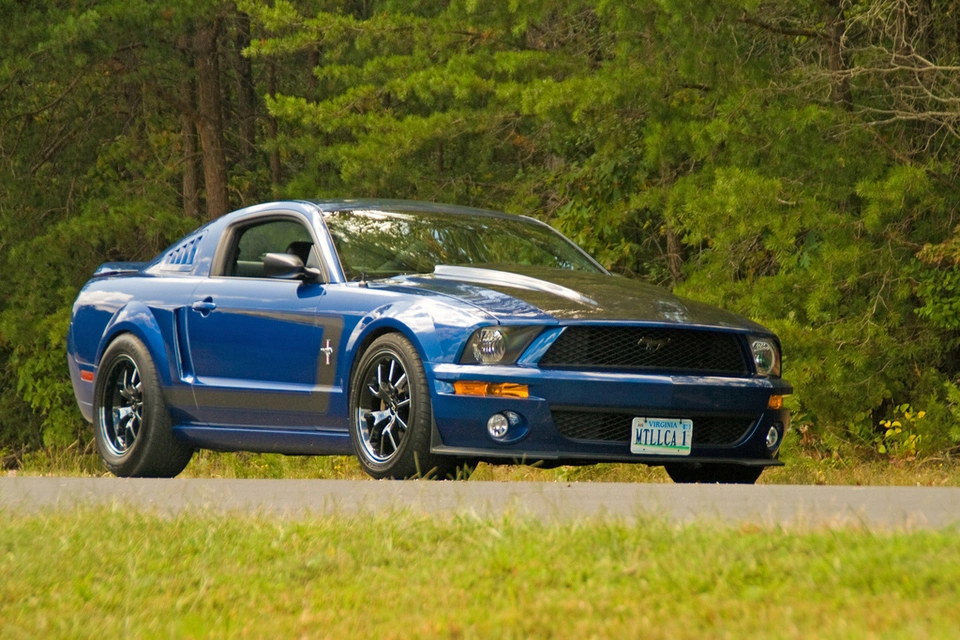

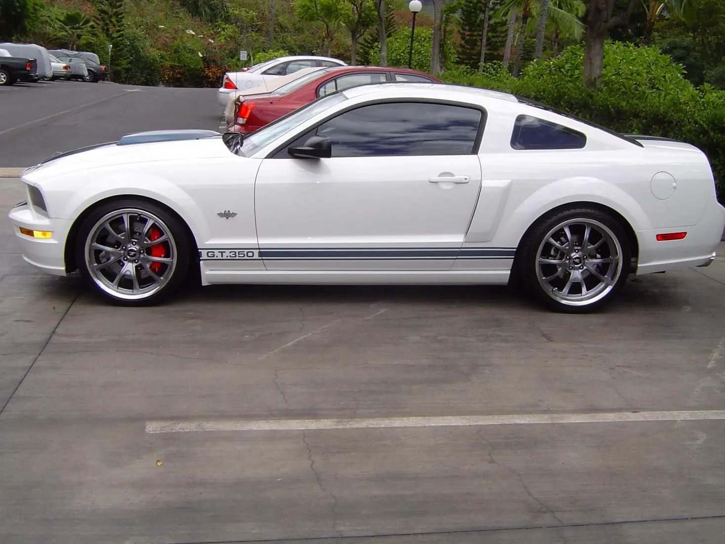

Wheels:
Brand - America Racing (Shelby)
Model - Razors
Wheel Diameter - 20"
Offset - Not sure
Did you need/use a spacer? - No
Tires:
Brand - Pirelli
Model - P Zero
Size - 255/35/20
Suspension Mods - Eibach Pro Kit Springs, Tokico D-Spec Shock/Struts

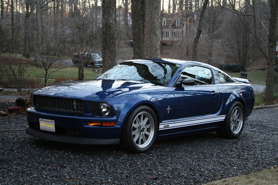

Wheels:
5 Zigen
Pro-Racer GN+
18x9.5"
+43mm
Did you need/use a spacer? I needed to use a 1/8" spacer on the front only because the S197 hubs are deeper than the recess in the wheels. They also required the hubcentric centering rings and special lug nuts that came packaged with the wheels.
Tires:
Cooper
Zeon 2XS
275/40-18
Suspension Mods: Tokico D-Spec shocks/struts, Vogtland springs, J&M LCA's, Spohn adjustable panhard bar, Stillen adjustable F&R stabilizer bars.

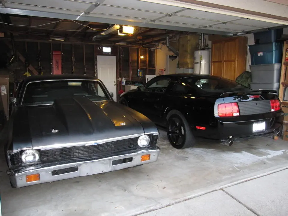

2007 must gt/cs
wheels
brand: OE
size : front 17x9 rear 17x10.5
type: bullitt
offset: normal
spacers? no
tires
front fierce 275/40/17
rear michelin pilot sport 335/35/17
no susp upgrade and plenty of room for these big boys

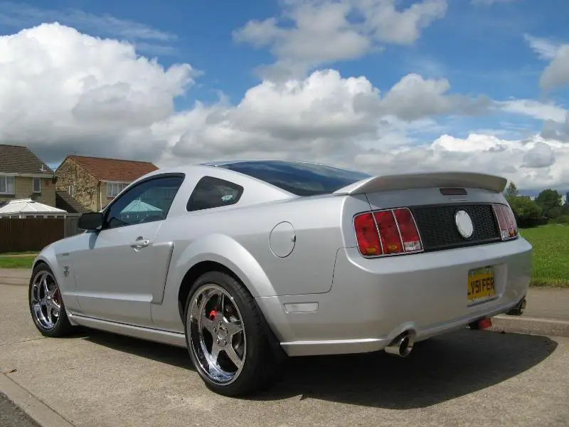

Wheels:
Brand - Weld Evo
Model - Forgestar Chrome
Wheel Diameter - Front: 20X9.5 Rear 20X10.5
Initially, when I bought these wheels in 2005, weld had to supply thin spacers as they made the first batch of rear wheels incorrectly. Subsequently, the rear wheel chrome shattered and flaked and had to be returned under warranty (at my considerable expense). The replacement rears were obviously redesigned in the inter-rim (see what I did there..)and are a little chunkier in design.
Tires:
Brand - Dunlop
Model - Sportmaxx
Size - Front 275/35/20 Rear 275/35/20 (rears aren't wide enough and will be replaced with 285 or 295 when they wear out.)
Tokico D Spec adjustables and Roush lowering springs, SHR rear panel and medallion, Spoiler Store GT500 spoiler and hood scoop, chrome tail-light bezels, Prospeed exhausts.
Can't seem to edit the original post so I've updated the details.

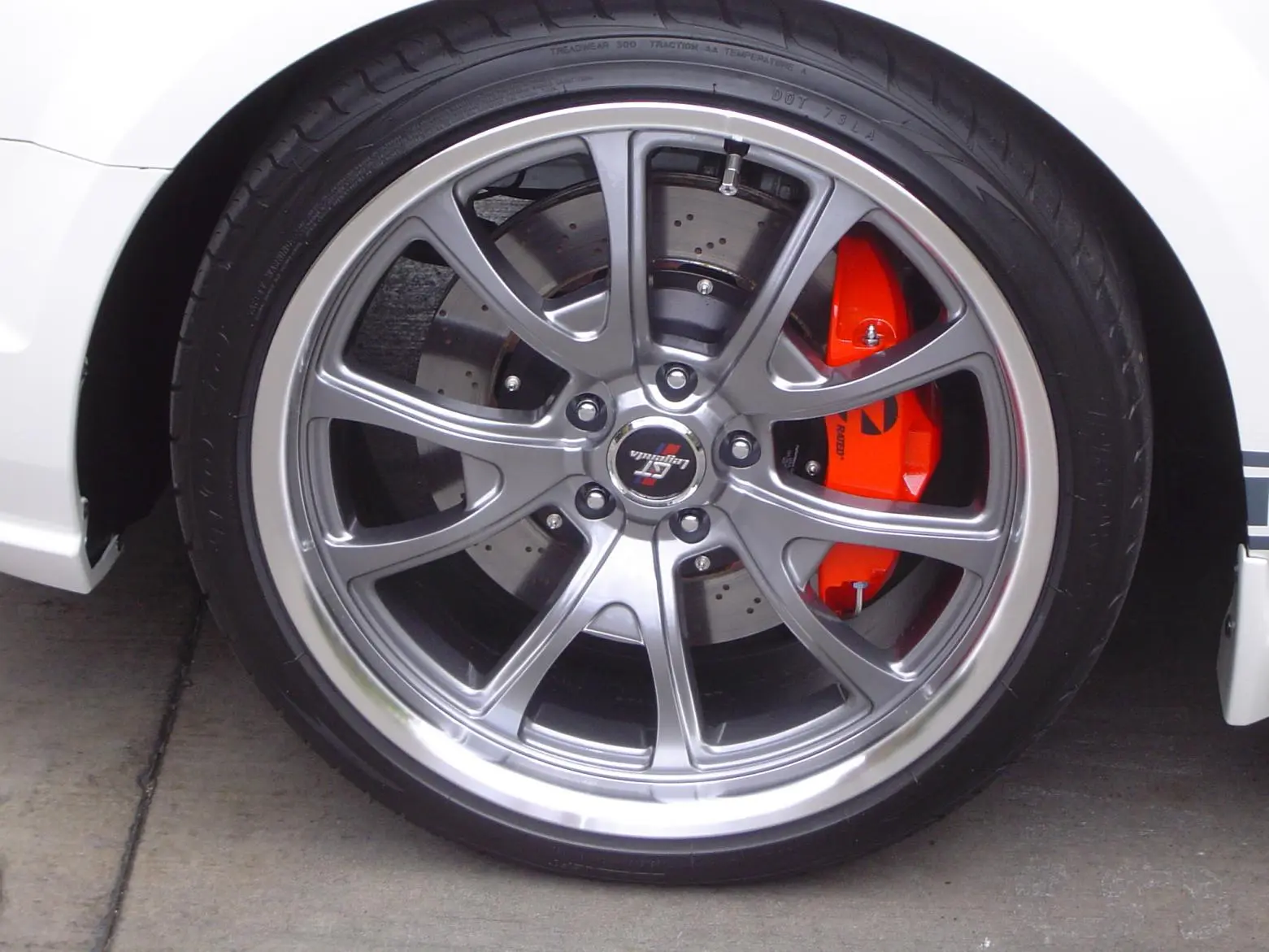

2007 Mustang GT
Wheels:
Brand GT Legends
Model Ghost
Wheel Diameter 20
Offset Front 30mm Rear 38mm
Tires:
Brand Toyos
Model Proxes 4
Size Front 245/35/20 Rear 295/30/20
Eibach Pro Kit

Aren't those the wheels that Cervini uses?
Can't seem to find the brand all I can come up with is the Driving Simulator GT Legends which incidentally uses the same logo and type :D

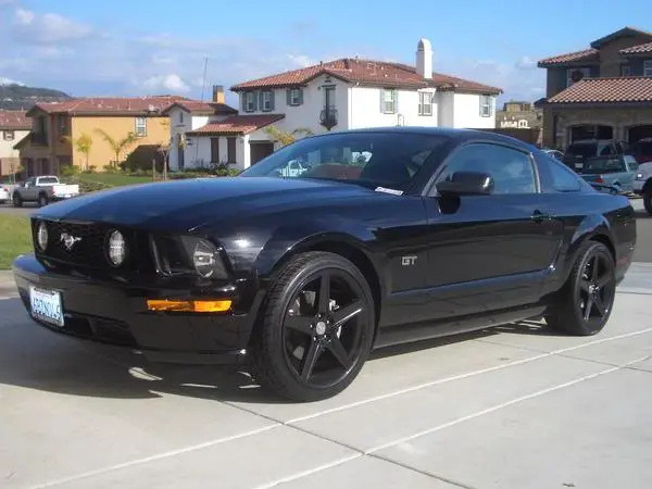

Wheels: Toxic
Brand: Tocix I think
Model: 5 spoke Saleen look a likes
Wheel Diameter: Front: 20x9, Rear 20X10
Offset: sorry I wish I knew
Did you need/use a spacer? no
Tires: Proxy 4s
Brand: Toyo
Model: Proxy 4
Size- Front: 255/30R20, Rear: 295/30R20
Suspension Mods if any: None
