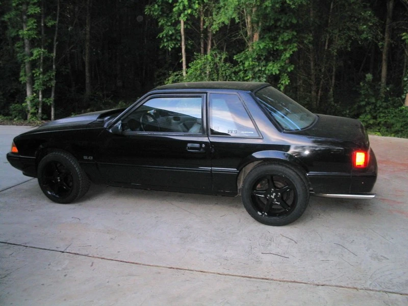

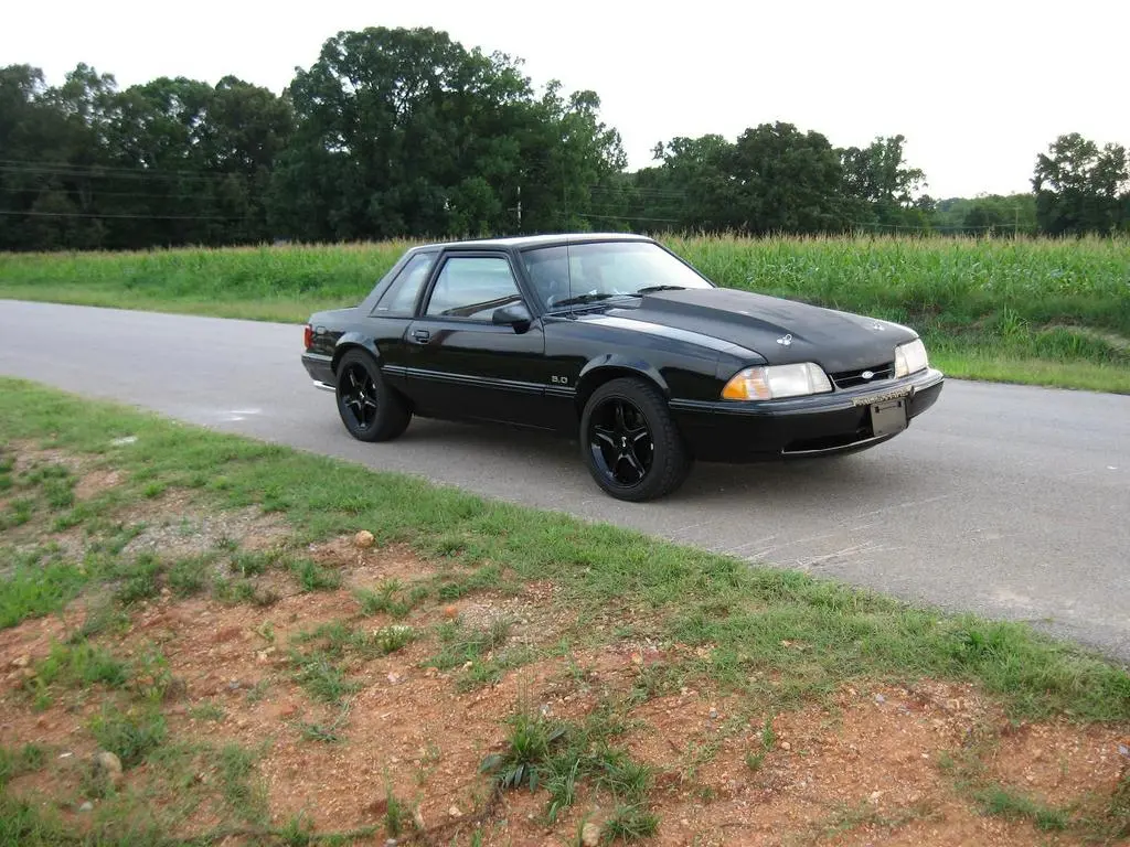

Here's the problem. As you can see in the pics, my mustang rides way high in the front. Now that we took 70lbs off the front end it's worse than the pics show.
I have powder coated black 17x9 4 lug cobra r's all the around. I cannot find this wheel in a 17x8 or a 16x8 for the front. I am worried about rubbing issues.
Are any of you running 17x9 cobra r's on the front with lowering springs? If so, what size tire do you use and how bad is the rubbing? What kind of lowering springs? I don't want to go back to the pony rims because I'll have to buy 4 new tires to fit them.
