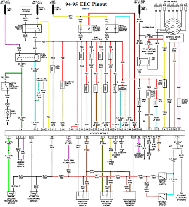

Yeah, I got a hold of a noid light and will be using that this weekend. Also, question for you. The ground appears to be a red wire, for all the injectors. I'm wondering how they are switched? Also, sounds like the ground retuns to the ECU. How is the ECU grounded? I'm thinking I might have a bad ground somewhere... I guess I gotta get a hold of a wiring diagram to see how it's switched and so on...

Found this:
So if I'm seeing this correctly, brown/yellow is suppose to be the switched ground for the injector? Looks like the red wires are hot at all times.
Red is the power to the injectors. Brn/yellow should be the ground for injector 3. Remember, they share accessory 12 volt power but have individual grounds from the EEC.
The big EEC ground is below the EEC in the kick panel. This is not where I'd be looking since only one cylinder is apparently affected.
Remember, you can have noid light "pulse" or flash and still have a bad injector (pintle failure) so check that injector with a tester, stethascope/long thin screwdriver compare to others, it should "click" each time it's energized and that means grounded by ecm, common failure in EFI cars.
Yeah, that's true. If only one is affected, then the brown/yellow wire is the one I should be worried about. Also, when I last put a volt meter to the brown yellow wire, it was reading battery voltage. Tell me I'm wrong?
