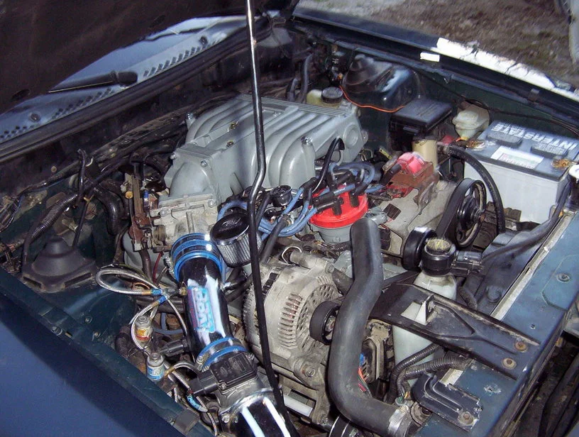

You should be able to see where my nossle is mounted from these pictures.

As you see from the pictures, mine are hose clamped to my fuel lines to prevent them from flopping around too much.
