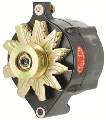

can you be more descriptive? the powermaster alt gives a cable with it
while i dont see any mention of any cables included with the pa performance one. pa does offer a std short cable kit for an extra 30 dollars though.

Definately get the PA Performance alternator,or one like it (Alterstart, Inc. has 130 to 200 amp 3G alternators, relatively cheap, with lifetime warranties). I believe the Powermaster alternators are self-exciting, and do not start outputting power until after they reach a certain RPM. You have to rev up the engine after starting to get power out of the alternator, or you'll just be draining the battery.
The PA Performance wiring upgrade kits include everything you need. You could find all the parts separately for less money, but it'd be a PITA, and you wouldn't be saving that much.
Do a Google search for "Mustang 3G alternator upgrade", and you'll find a bunch of articles that'll give you steb-by-step instructions. The hardest part is trimming the alternator bracket to fit the larger, 3G alternator. Using a Dremel tool and cutting wheel took me about 45 minutes to make the cut. I've heard of folks using a file, but I can't imagine how long that would take. A die-grinder would take about 10 minutes.
Even with the cutting, I did the entire mod in less than 2 hours. Definately worth the money and time.
I have a powermaster and I love it. The 1-wire hook up is as easy as it gets - no modifications needed and the wiring is all included. However, it does need to hit a specific RPM before it "kicks" on, BUT when you start your engine, the RPM's go up a little anyways and that's usually enough to get it started. It's not like after you've been driving a bit and come to a stop light, you have to keep it at a certain RPM to keep it going. Once it's on, it stays on until you shut off the engine.
