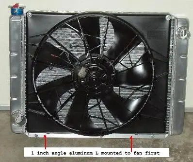

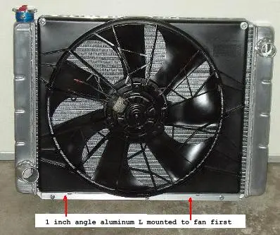

I am using the one Summit sells under there name, but its made by Northern. It does not have a trans cooler in it, but I am running a 28,000 GVW external one anyway.
Here it is with my MarkVIII fan on it.
Here is the full cooling system information.
