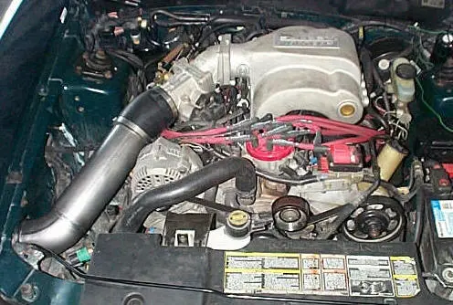

Here's my set up. I just don't see where it gets much straighter than this.
I don't think bends in and of themselves are a restriction. There may be air flow turbulence issues but, again I can't see where 2 45* bends would be worse than 1 90* bend. Intuitively one would think just the opposite.
