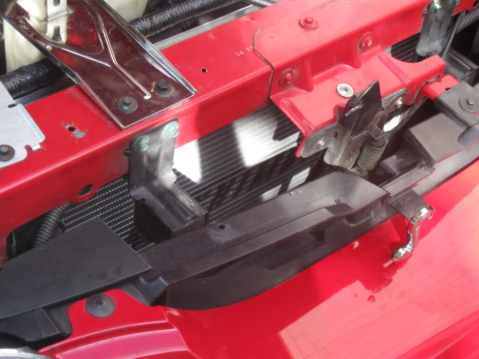

Heres a pic of mine, the fender has not been grinded yet, but I know I can get it better than this.
