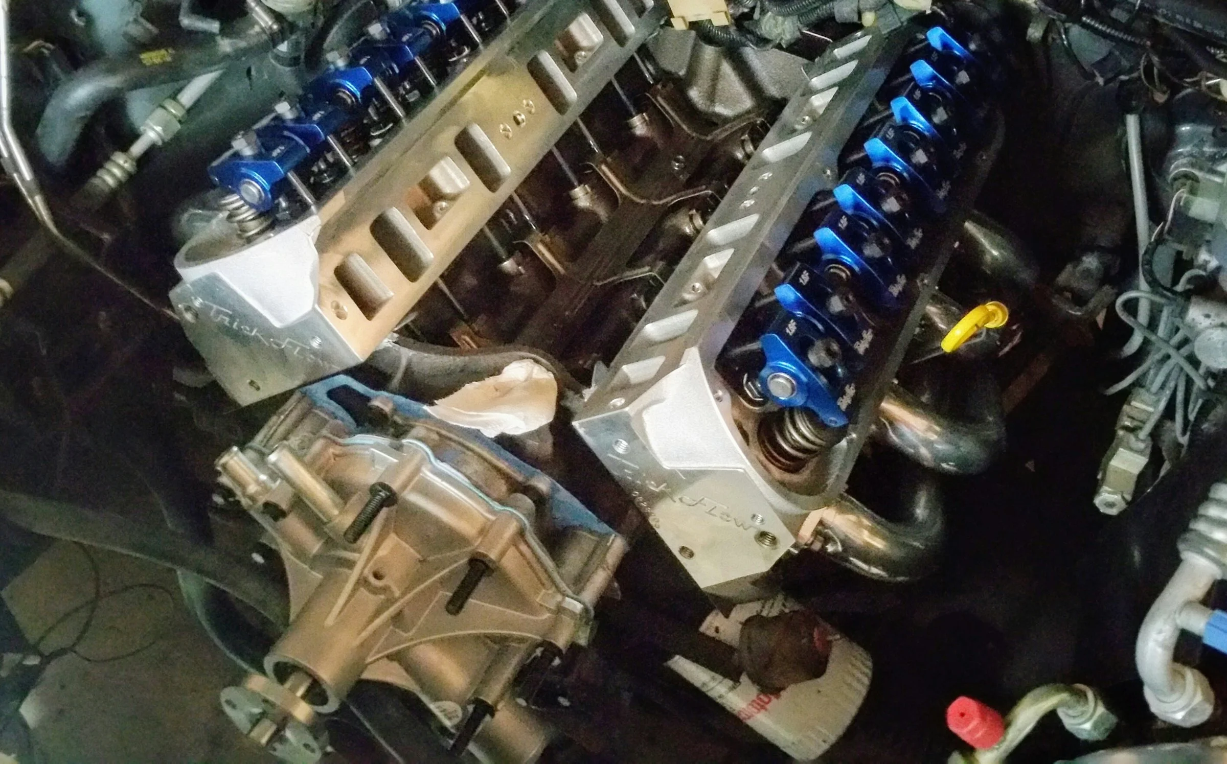

I went with the Trick Flow 170 heads, happy with them after a year now. The heads come with a plug each for the front of the head to bolt on your accessories, if your not gonna use the cross over you'll need to purchase 2 more plugs, or slap a bolt in or whatever.
