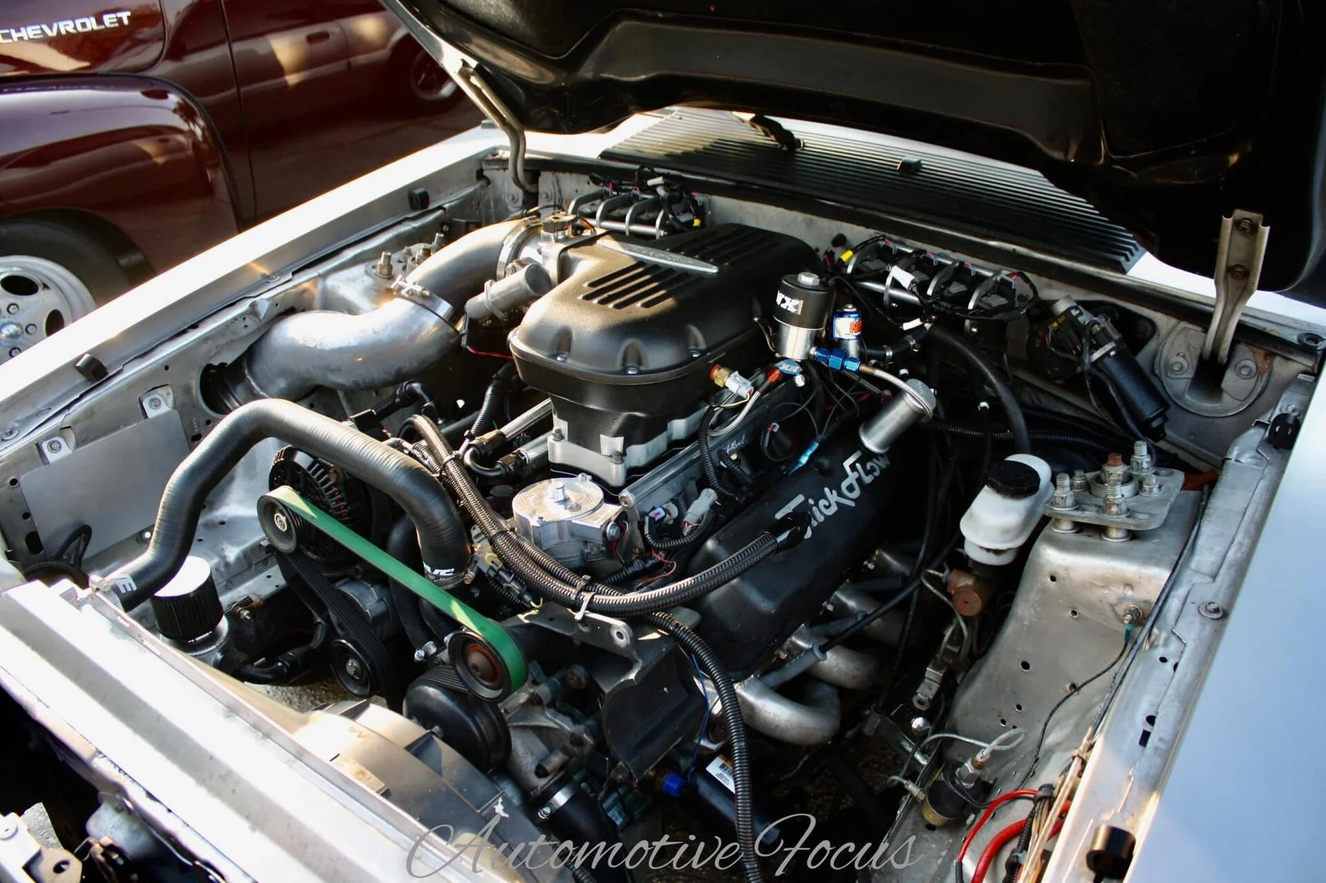

I’ve been running a box r on a 347 for the last few years. It’s actually a great intake for street use.

Are you running a 90mm throttle body? I have made up my mind on getting the kick ass looking Box R. Thank you to everyone for your feedback. I greatly appreciate it.
Yeah I have the 90mm. I actually had a 75mm on a sn95 that I had the intake on before and it ran good as well. You’d be surprised how much torque down low the box r will actually make.
