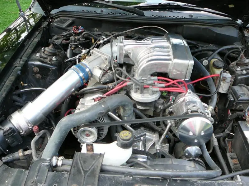

but it still can vary depending on the way it is clocked and if there are bends in the tubing before the element. mine is a straight shot into the fenderwell with 4" PVC and no bends.
if you are interested, i can snap a couple pics of my setup for you
yep, lightning. unfortunately, the homemade adapter is not visible as it is in the fenderwell.

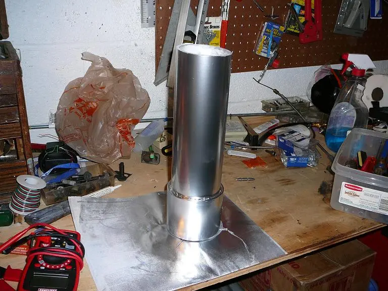

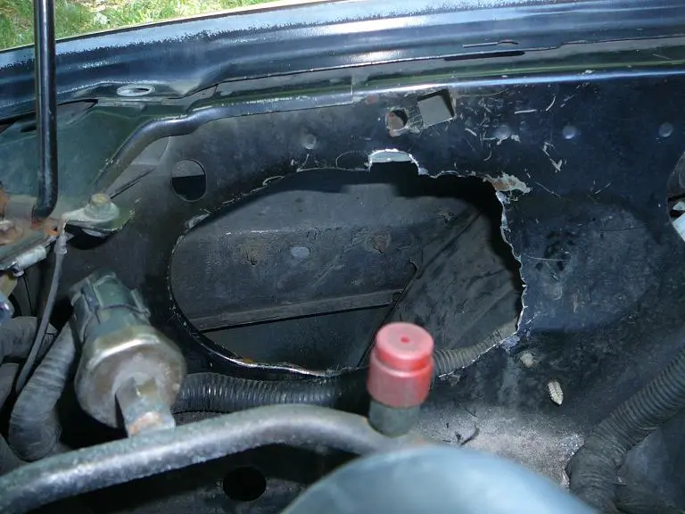

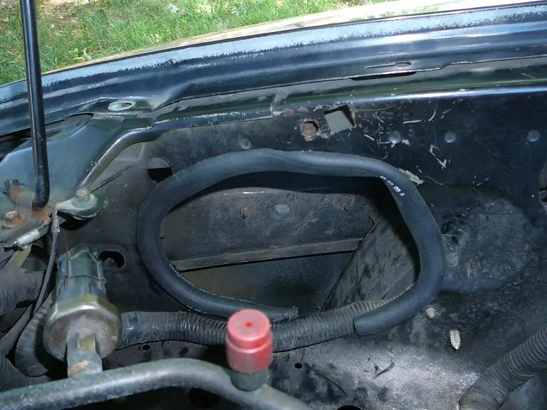

i enlarged the hole to the fenderwell and slit a fuel hose lengthwise and lined it with the hose. then i made a tube with pvc from home depot and painted it silver. i'm happy with it

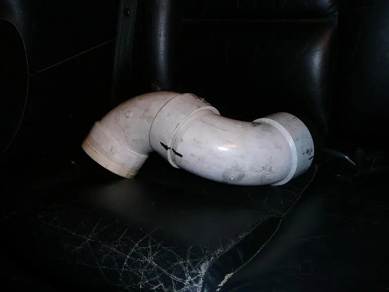

the old bends before the meter ... they caused havoc with the readings
