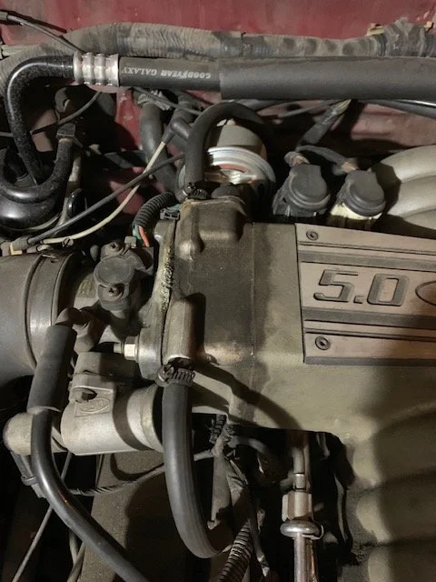

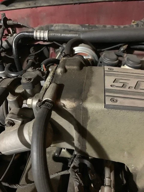

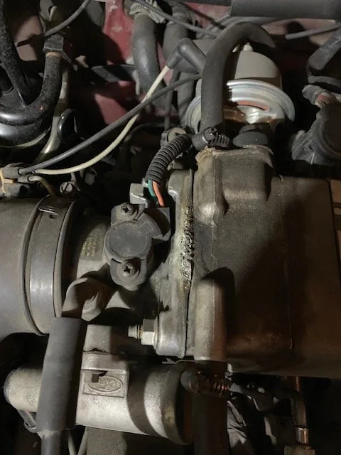

Still went with the 70mm Now looking at buying the intake. Never seen this before so not quite sure why it looks like this.
Looks to me like that's buildup from the EGR cooler plate gasket leaking coolant, which could also be leaking into the intake and engine. Have you noticed any coolant loss?
Likely fuel pump.
that buildup looks to me like electrolysis, if it's kinda powdery, it's a condition when liquid flows through aluminum with steel parts like bolts or in this case studs. Gasket is definitely leaking. A new egr spacer and throttle body with new studs/nuts and washers are in order.
No I haven't. Car ran fine all the way back from California and never overheated even in the 109 temp. Just have power loss when I first step on the gas so no giddy up on it.
I wouldn't expect there to be significant coolant loss if that leak is just on the outside. Probably just seeping through and causing the buildup you are seeing. I agree with @General karthief , you def. need to fix that issue but that shouldn't be causing your loss of power.
