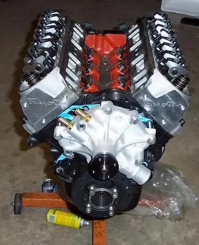

This is mine, with the edelbrock pump on it..
