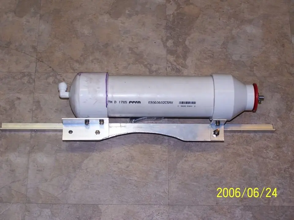

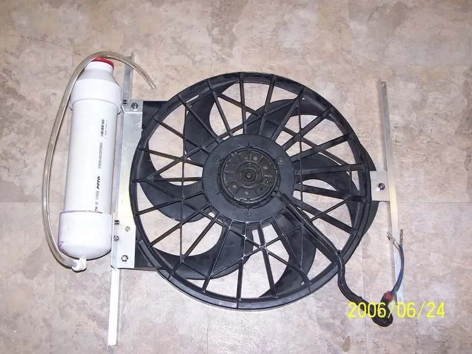

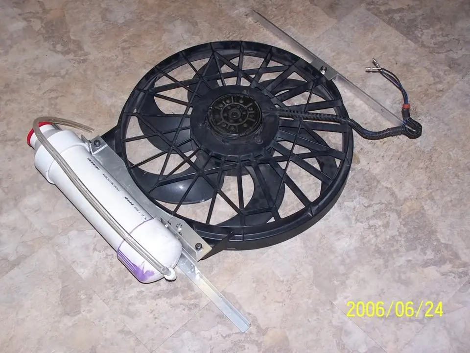

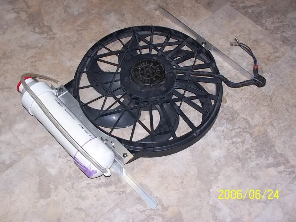

The tank is all PVC pipe & plumbing stuff from Home Depot, very inexpensive, but very hardy.
The only problem with mounting it down low like that is that it makes it harder for the radiator to "pull" coolant back from the reservoir into the radiator. Makes it easy for pressurized coolant to escape INTO the reservoir but when it cools down it needs to pull some back into the radiator. That's why normally the bottles are mounted closer to the radiator, that is, if it's a true overflow setup as opposed to a pressurized bottle like a lot of newer cars use. If the overflow tank is mounted close, it's much easier for the cooling system to "siphon" coolant back into the radiator as it cools and contracts.

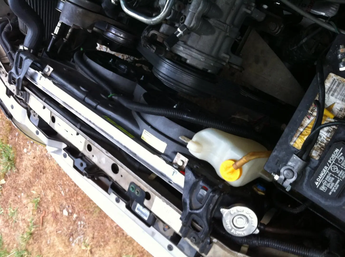

see what you think of this. Nothing set in stone yet and it's not screwed down yet, but it fits well. Also this is a used (and discolored) bottle..have a new one to permanently mount to the fan shroud.
