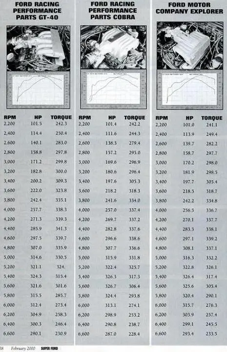

This can not be right. I didn't think it was so I googled "GT40 vs explorer intake" b/c I wanted to see a side by side. But I found this. Look at the dyno chart, then this is what Tmoss himself wrote on allfordmustangs "Gt40/Cobra/Explorer all flow within a couple of cfm of each other - and if you've seen that old 1996 test on Eddelbrock's website - don't believe it as it has been proven wrong over and over and over......"
Somebody's measuring method is flawed here.

After looking at the numbers I am questioning it myself, as I have seen that article before too. Althought we are also just talking about the lower as that article refers to the horse power and torque numbers which include top and bottom. Which to me even though they look alike, I have a hard time believing the runners are the same length and size.
