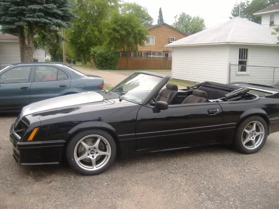

Go to your paint supply store and ask for 99k it's the paint code from the grand national... Well there goes half my secret....LOL Also like said above its all in the prep work trust me I've seen guys with House of Kolors 10k paint jobs that look like the end result of a prune smoothie

Straight black no tint added to it. Buddy of mine runs a body shop and said that was the blackest he could get it.

I love that black. Holy mother of all that is black. :hail2:

The best black is a black that isn't 100% black....i would do a custom mix with maybe a little pearl mixed in or a tiny bit of cherry red, not enough to change it from black but enough to give it some sparkle and depth so it's not just basic black.

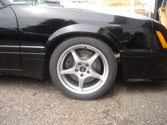

I am seriously hoping that my paint job turns out that slick!! That is some awesome paint! What are the specs on your centerline wheels?? width and backspace? Im thinking of getting either the Ventura or the Thruster wheel after I get this paint job paid for
