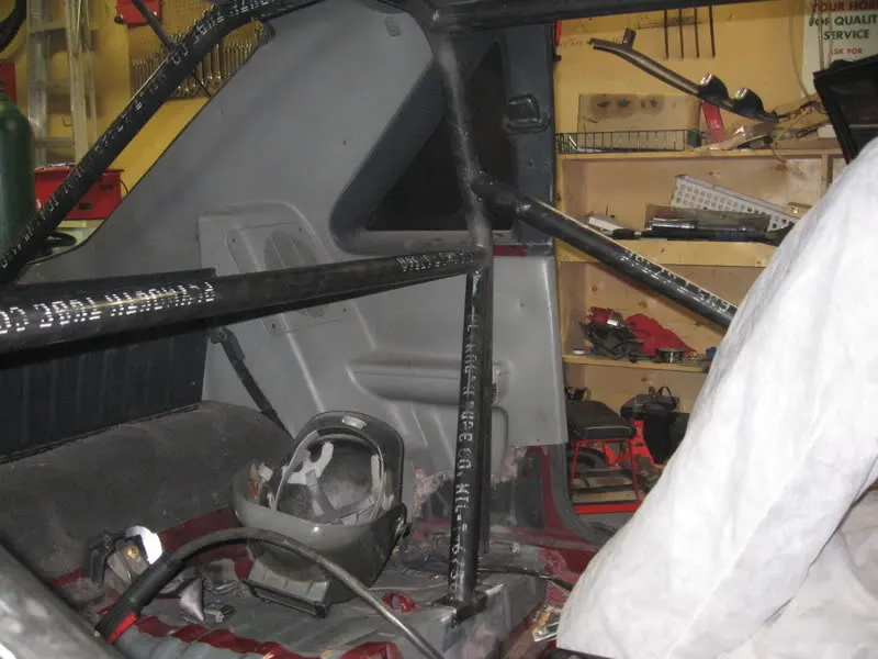

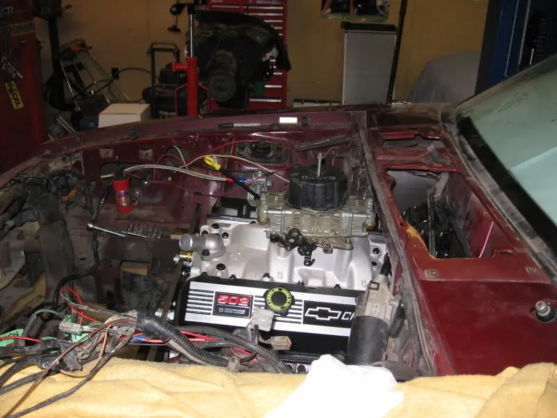

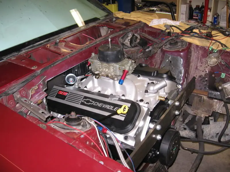

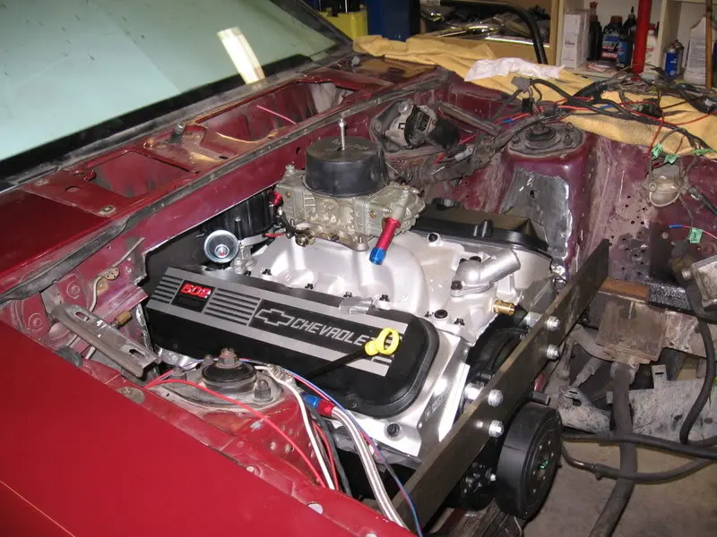

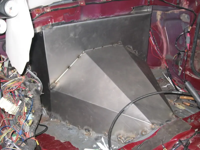

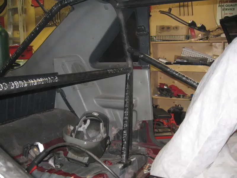

Sounds like your building a car alot like my friends...

Ah come on guys,its just gunna be a bracket car,and besideds its barely a Mustang,more like just an empty shell. Oh,and it was a broken,beat-up 4 cylinder befor if it makes it any more permittable. :)
Dean85GT,thats not quite what I had in mind,but close. This car is TOTALY stripped of everything;trim,sound deadener,wiring,interior,and it will have lexan windows and a chomoly cage all to keep wieght to a minimum.Also,it looks liek the BBC sits back in there quite aways,and might be a real bitch to change plugs and set the timing,witch would be important,especialy sense I plan on runing it on methanol with maybe a touch of nitro :) (80/20 at most if I can afford aluminum rods).
