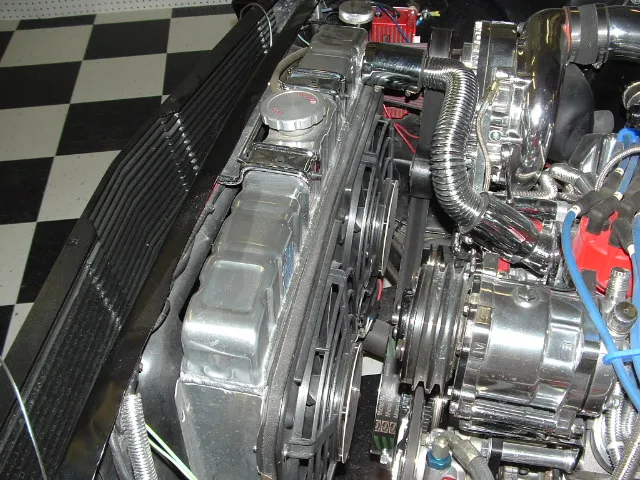

I have the 24 wide griffin alum with 1" cores and a flex-a-lite twin slimline fan. My car runs 205-210 no matter what the temp is outside. However it does not move from there. I can idle for 45 minutes and the temp doesn't move. Granted I live in hotter than hell Vegas!
...and that is on a supercharged engine too...which adds a lot of heat...in case somebody hasn't been paying attention :D
