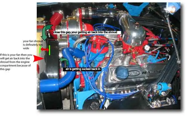

THANKS FOR ALL THE HELP. Here is what I try'ed so far, I put back on the flex fan and shroud like in my car domain pics, the temp is about the same with 170 to 185 down the hi-way and about 210 in traffic or at a red light and outside temp about 85. I think thats still to hot and might be on the border line of overheating. I have my trany cooler in front of the radiator because I cant find a better place for it in my 65 stang. I think I will look for a duel fan setup that fits my rad and try that.

i also knotice in your car domain site that there is a gap between the shroud and radiator.....you will need to close this up. the fan will do nothing but pull air into this gap. also it looks like the fan is too far into the shroud....if that is a belt driven fan can't tell. the fan should be as close to half in and half out as possible....the sweet spot. if its too far in then it'll recirc air back into the shroud and if its too far out it will suck air into the shroud from the engine conpartment. remember air follows the path of least resistance.

Thanks Steet,,, I will take a closer look at my fan spacing but I know That I dont have much room because of the blower belt setup. I was thinking of making a fan shroud anyway to get rid of that black plastic thing.
