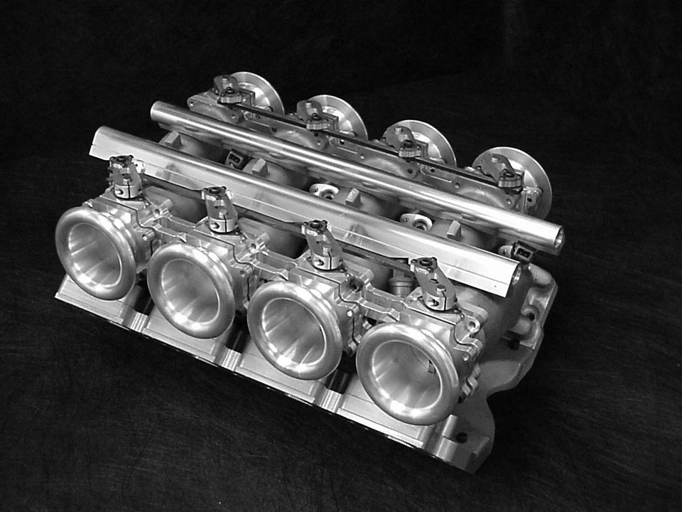

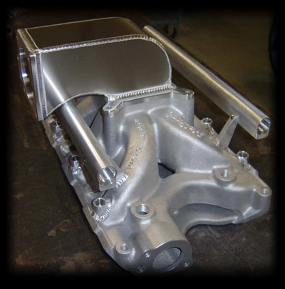

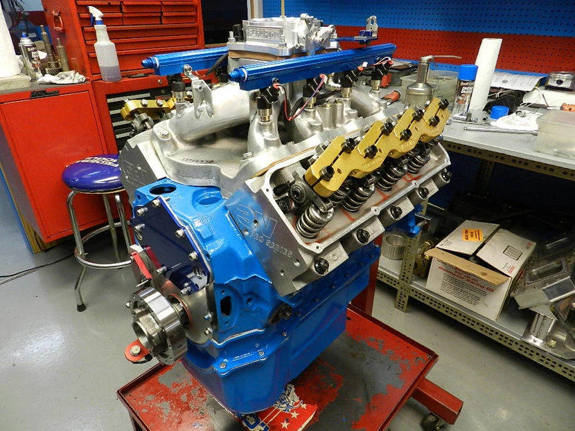

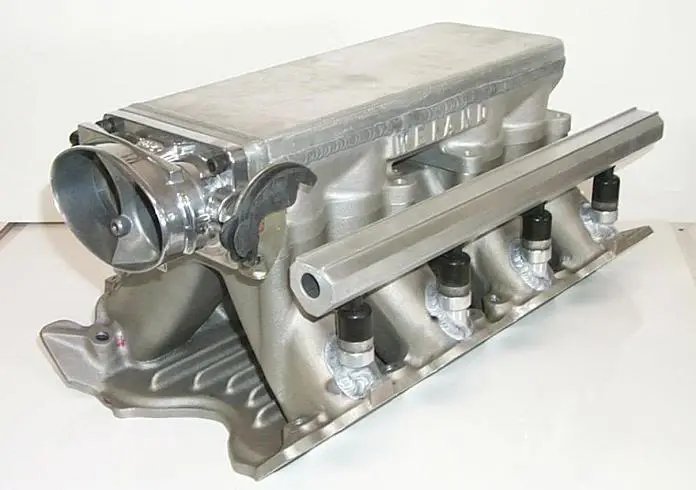

Most guys will make their own EFI intake. Here are a few examples:
Crossram anyone?
I'm into my build for no more than a comparable 351W build and am utilizing a set of 4V Closed Chamber heads.
