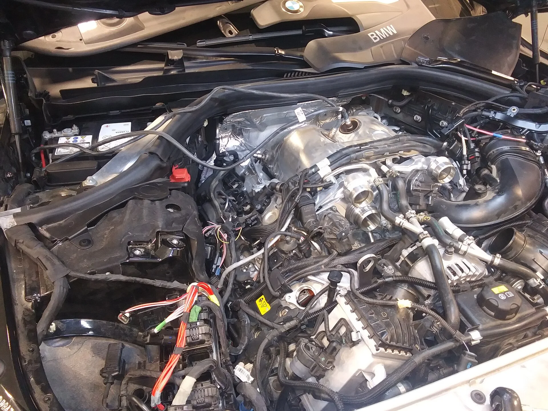

Holy hell i'm never buying a BMW. That looks...complicated.
Complicated? It's just a DOHC twin-turbo REVERSE-FLOW V8 with two separate cooling systems, two computers to run the engine, and extra crap like Valvetronic that serves no purpose other than to generate revenue for dealership service departments... I mean... Um... Provide more precise control of engine air intake than apparently an IAC or ETB can.
It's not that complica... Yeah, it's complicated, hilariously and stupidly complicated. Unnecessarily complicated in ways that give me actual headaches.
Reactions: 2Blue2 and HemiRick
What model is it?
The engine is known as the "N63" and is as much a technological marvel as it is a nightmare to work on. This particular car is a 2017 BMW 750. It can be found as an option in every car from the 5-series up and every SUV from the X5 up. https://en.wikipedia.org/wiki/BMW_N63

Speak for yourself, I'm taking a break from replacing a rodent-chewed engine harness on one BMW 7-series while I run a software update on another in the bay next to it
From someone who has a 650, THAT sounds like an intense job AND an Expensive one......

Very intense, subframe is supposed to come off to access part of the harness, as is the passenger side intake manifold. I actually took the wheel and the fender liners out instead to save time. I still need to pull the intercooler on that side Monday morning to unplug the VANOS on that bank, then I get to start reassembly. I also have an X3 with the B46 4-banger in it that needs the engine harness replaced for the same reason waiting on this 7-series to leave. Rodents LOVE BMW wiring.
