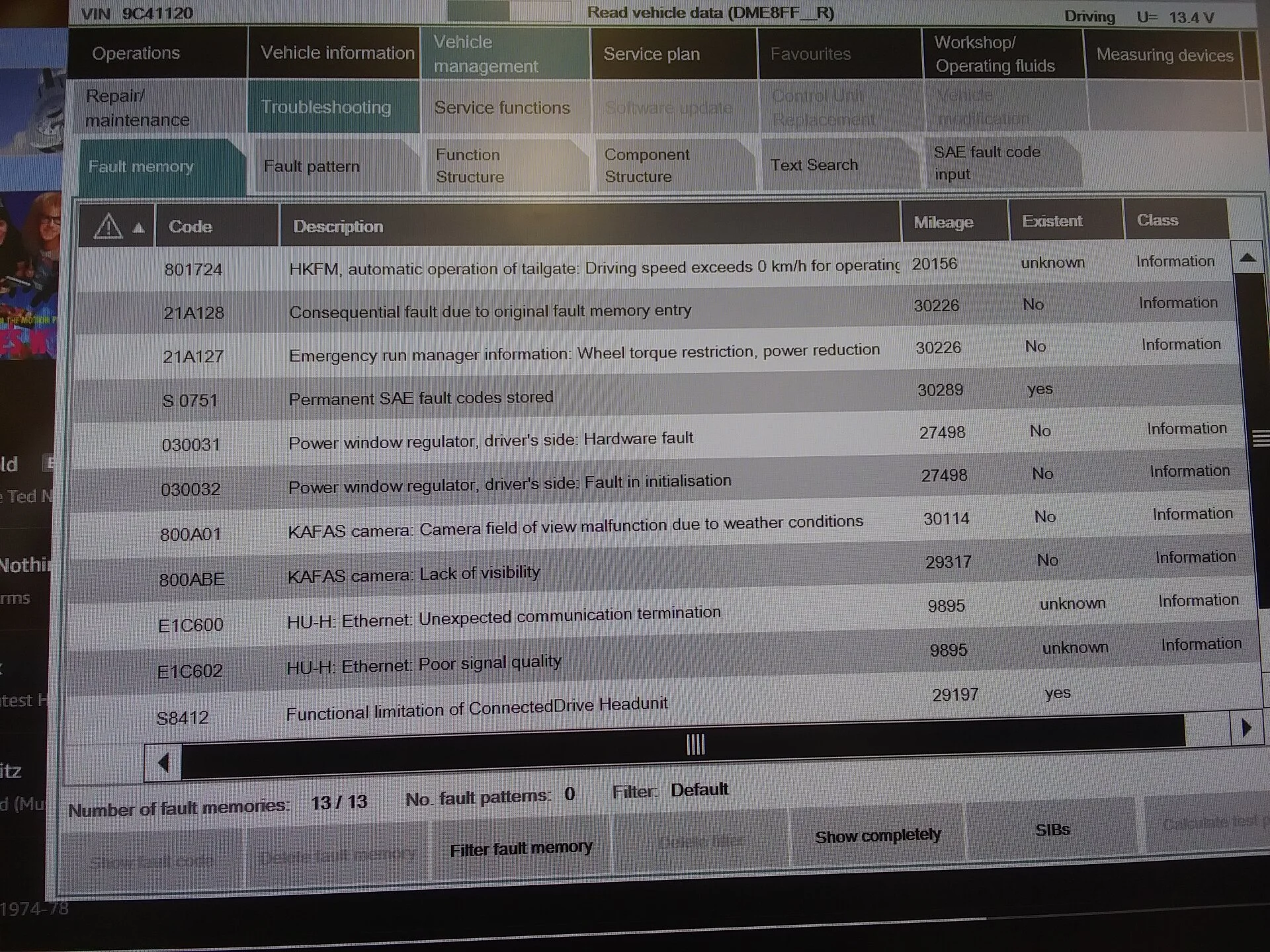

BMW diag is a whole new challenge for me. It was difficult with an aftermarket scan tool, it's both easier and more difficult with the OEM tool, easier because the BS 6-digit codes BMW uses are broken down succinctly. Harder because the sheer volume of information on the screen can be positively overwhelming. I can even tell if a customer was trying to adjust their seat and start the car at the same time because it stores a fault for that.
Take a look at this code read, there's literally a code that's generated purely because of another code!
What caused that? A rodent chewed the wiring to the forward knock sensor. No, I'm not kidding.

I can't believe that thing set a code for someone trying to close the hatch while the car was moving.
