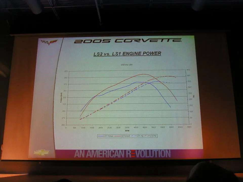

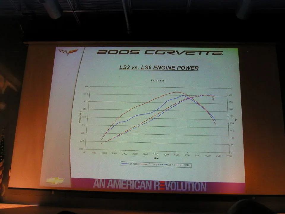

Please RE-READ my first post, i was not racing a stock LS1.
Please dont explain what horsepower and torque is to me, it is not new in my field.
I forgot the dyno graphs, here ya go.
Wheres that torque at again?

Oh BTW Dbeck002, if you ACTUALLY looked at the graph you posted you'd see the torque on the left is using a different scale to the HP on the right. I misse dit first off, but that's why it appears to be a very steep curve. If it used the same scale as the HP then it would appear very flat, although of course the meaning behind the data would remain the same.
The 4th line equals 330lb ft, the LS1 has exceeds this by 1500rpm. I would say it is VERY impressive, would you not? In fact considering an LT only makes a PEAK of 325lb ft @ 2500rpm, it's considerably more powerful down low as well as up top.
And sorry I didn't realise you'd raced anyone. Not sure I mentioned a race at all, will check. And sorry if I did.
I never said the torque was unimpressive, all i said was that it makes most of its torque too high in the RPM range for my liking. I prefer a grunty engine, with good torque everywhere.
The LS6 is the engine of discussion here since that is what i raced. Torque numbers by themselves arent going to tell me much, but torque to weight ratio is important. the LS6 has a poor torque to weight ratio down low, yes it makes good torque but we must consider the weight of the car as pure numbers mean nothing unless the cars were the same weight.
EDIT: Yes i am aware of the scale of the graphs but that would not change the fact that peak torque occurs at 4700 RPM for the LS6, (as you mentioned).

According to the graphs you posted:
LS1 PEAK torque of about 370lb ft @ ~ 4300rpm. However it makes over 330lb ft @ 1500rpm.
Which means an LS1 produces 90% of it's torque by 1500rpm
The LS6 admittidly produces it's PEAK @ nearer to 4700rpm, but it is 390lb ft.
And at 1500rpm it is still making about 320lb ft. So that's 82% by 1500rpm, which is still pretty impressive.
If an engine produces it's PEAK torque very low down, say 2500rpm then the engine will feel breathless if you try and push it high in the rpms. The LS engines will MATCH and EXCEED many alternative engines in the low rpms range yet will be happy at 5000+rpm.
So to re-quote you I would say the LS1 and LS6 are:
