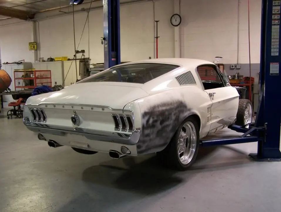

I got a really good deal on the rims I wanted for my 68. There 15x8 torq thrust d's with 4.5 backspace. I dont mid doing some fender flaring but I dont want to do any tubbing. It seems like its gonna be a tight squeeze with the inner fender wells on the back. I wanted to go with 275/60 but I want to spend that kind of money and find out I have to do some tubbing. I also realize using spacers may be neccessary but I would prefer not to if I dont have to. Anyone have any idea on the biggest tire size I could run without having to tub my car?

you might have a problem in the front with the rim hitting the upper arm when turning. the big wheels (17"+) usually fit over the arm. I went with 15x7 in front, with 4.5 back spacing. it's a little close to the fender with 225 60's on it.
In the rear I went 15x8 with 5.5 backspace, and a 275 50 drag radial, and it's pretty close. I need to get the car moving to see how much rubbing is going on. I think with 275 60 the tire will probably rub.
The guy I bought the rims from said he had 225 on the 15x8. That seemed like a little overkill with an 8 inch rim but I never saw the car. He also said he had no spacing issues but I would assume not. I know that the 235/14 steel rims I have now have no issues but that is a different ballpark. I diagram would definitely help me out. Like I said I have no issues with beatin on my fenders but I dont wanna have any issues with the tires rubbing on the inside. I dropped the front end and I also plan to match that with the rear. Its hard to get a good idea when the car has no engine and trans in it lol but I figure I could stick them anyway.
