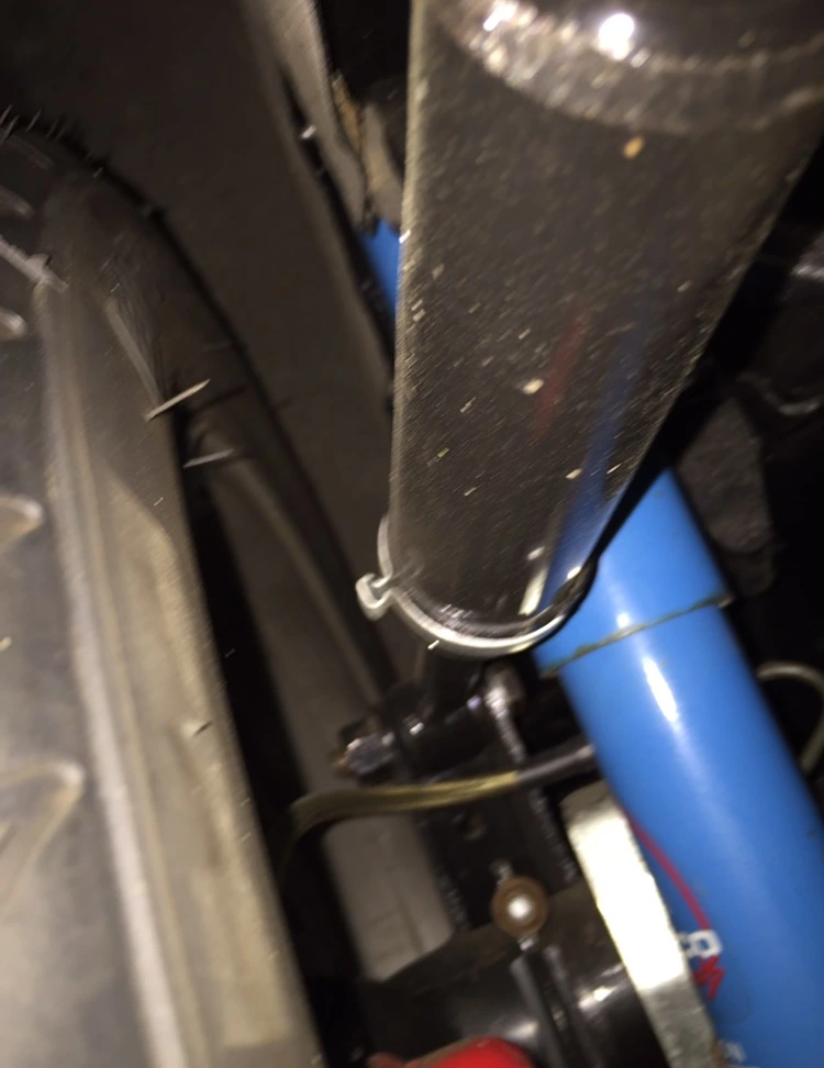

Rear wheels, on Sn95 axles. Take your standard 5.72" BS 17x8 wheels, and how much can you add to the inside before it becomes an issue?
WHat BS/offset are you guys with 9" and 10" wide wheels on Sn95 axles running?
With my 17x8 Cobras, it seems like I have a decent amount of room. But my main concern is articulation.
Tailpipes are also a concern. I don't want to remove them
I could possibly add a small spacer and come out a tad as well

Got my new wheel/tire setup on the car and taking a look at this again.

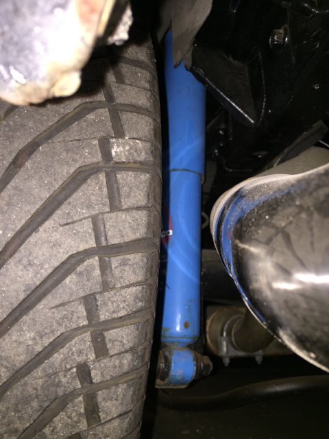

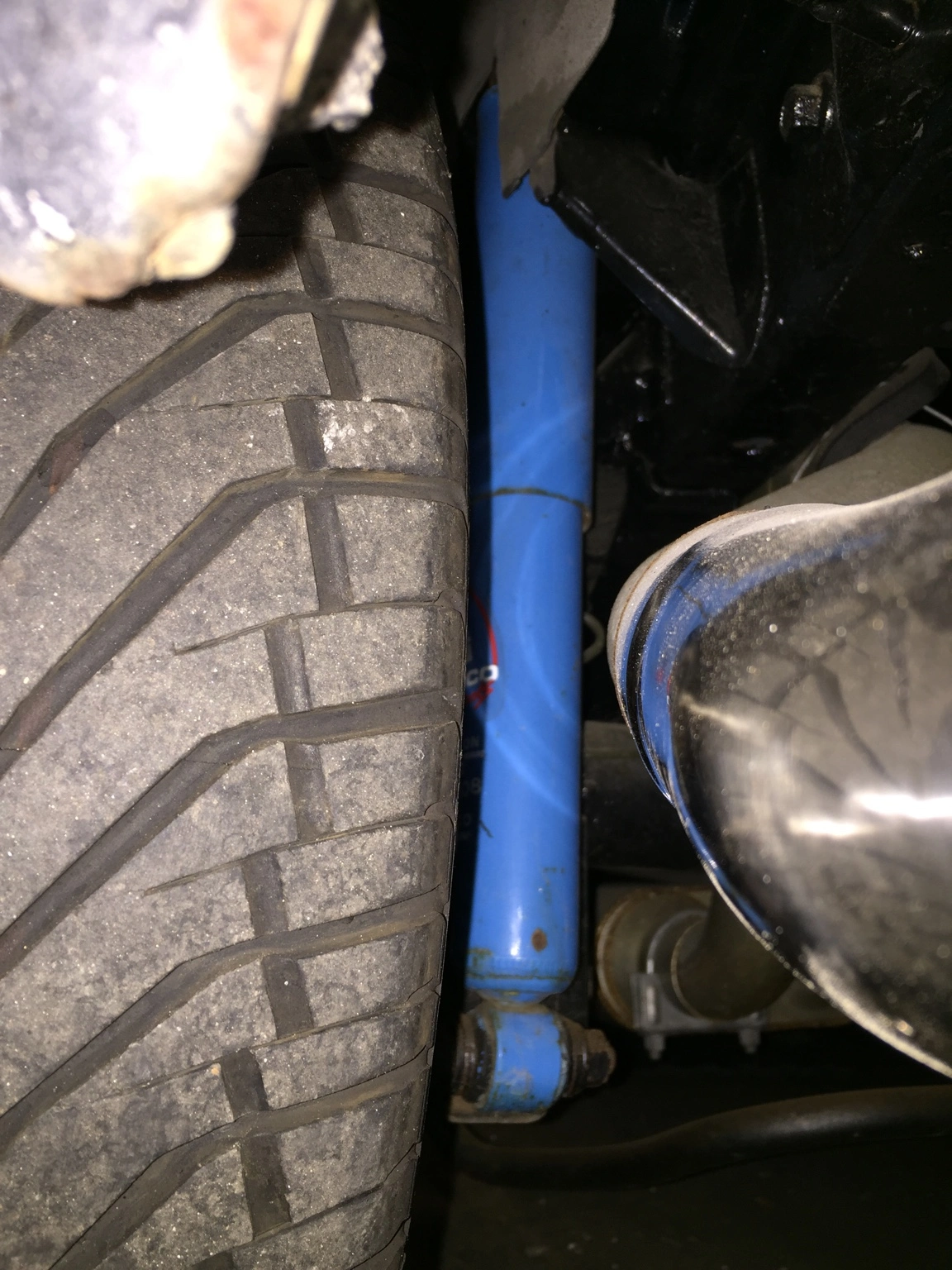

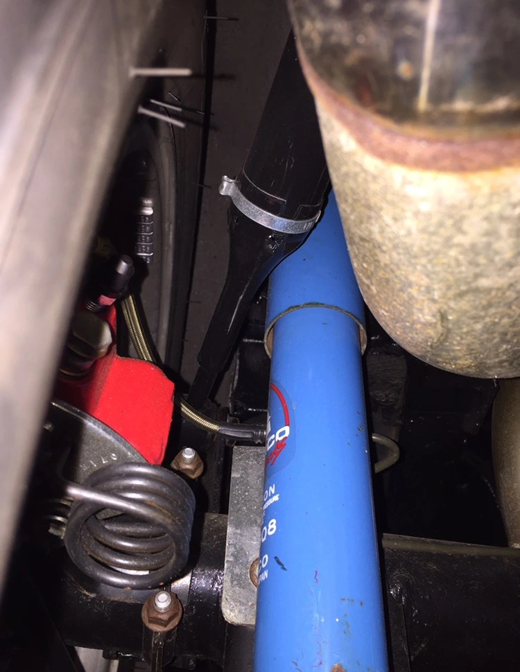

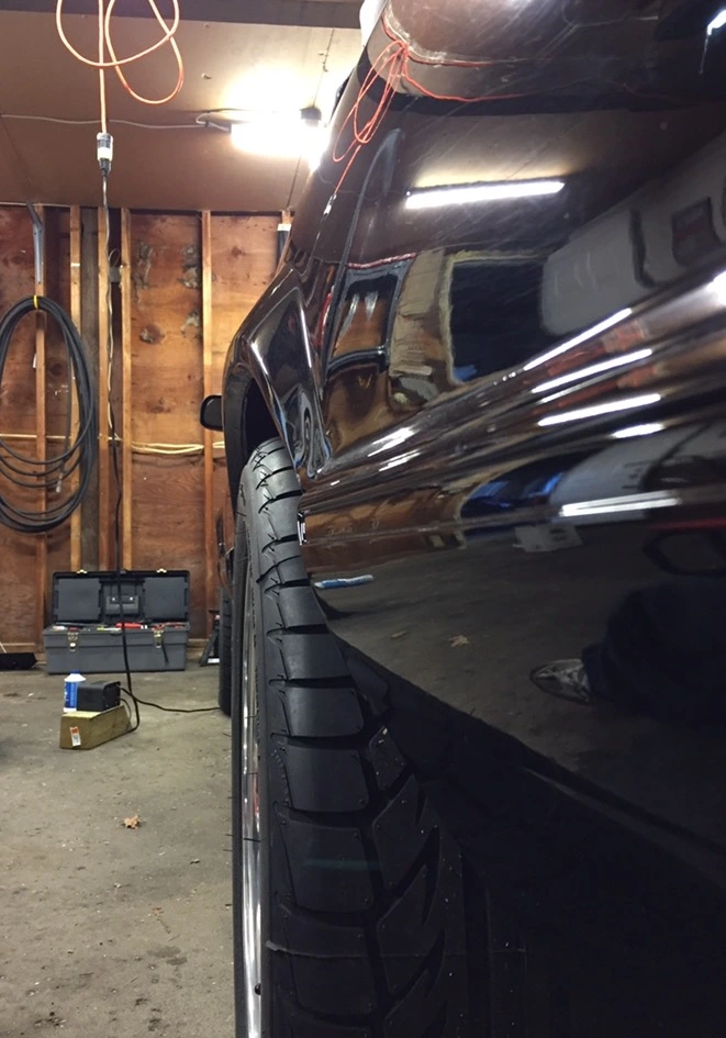

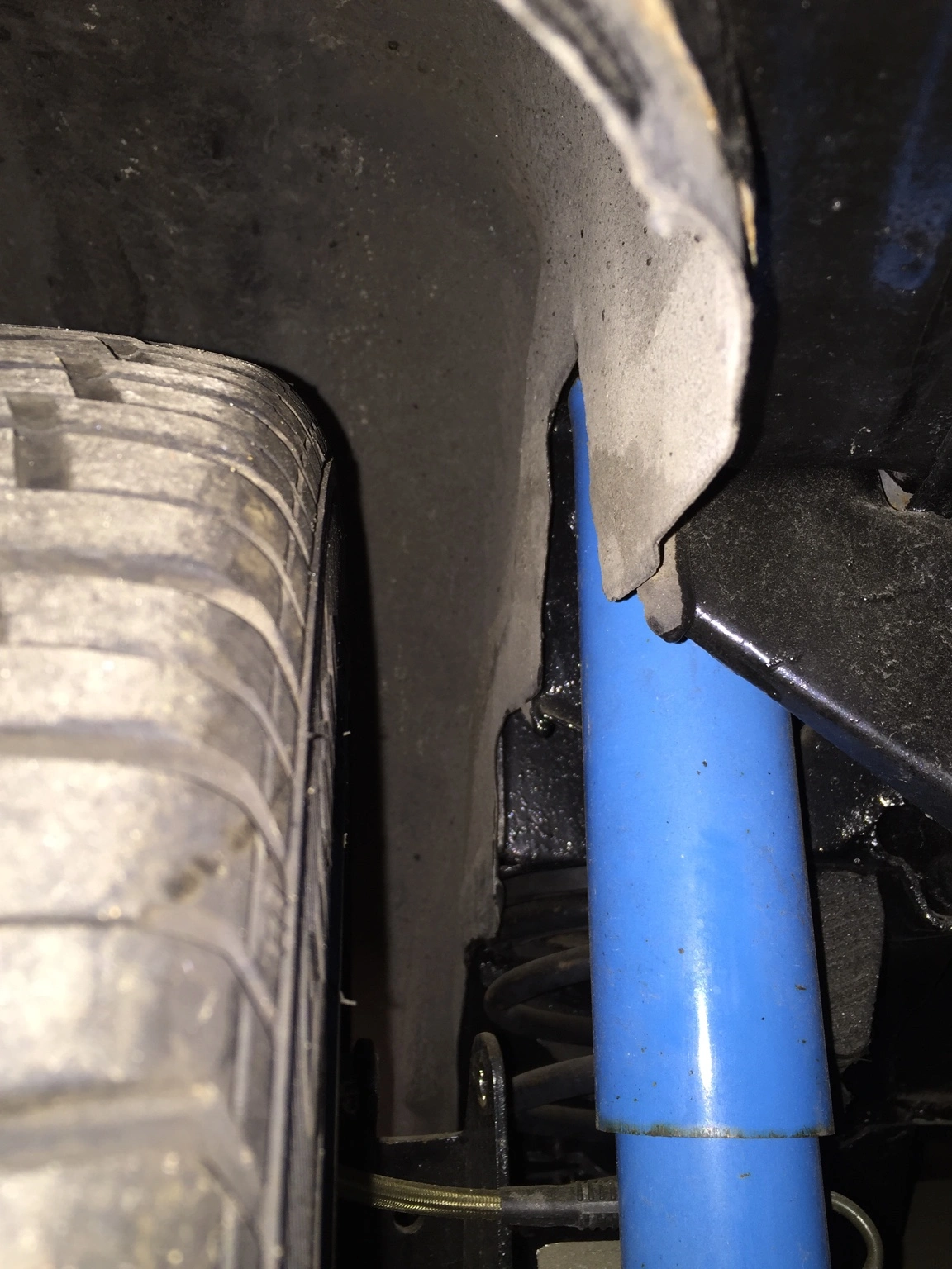

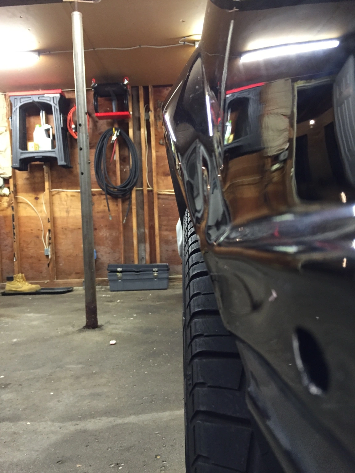

SN95 17x8s, with 255/45/17s mounted.
Some pics of current fit.
I'd go 1" wider on the inside with the goal of getting a 275 on there. Those quads are not flipped. I feel like getting 20mm of tire in the inside is doable.
Of course, cost. $200/wheel plus a new pair of tires.
