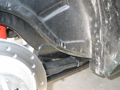

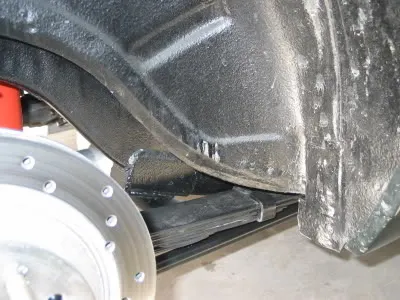

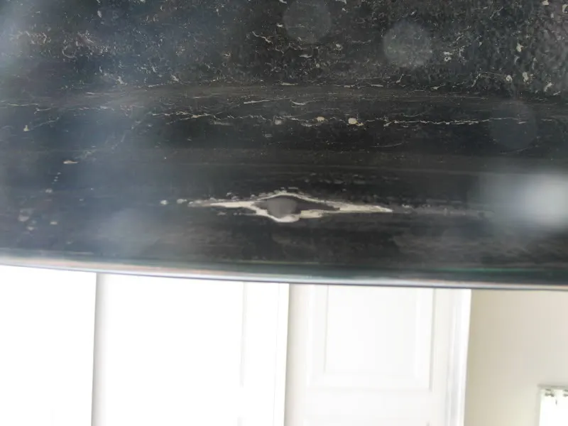

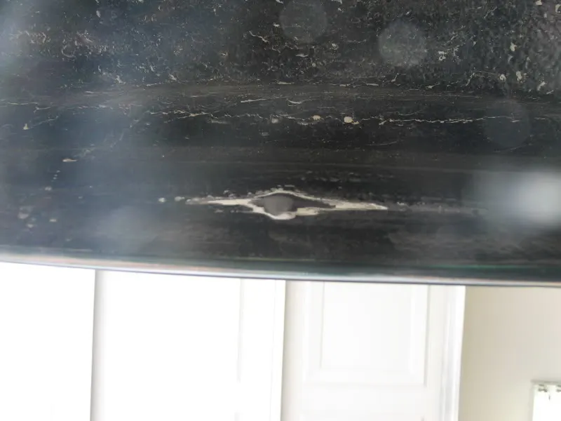

The biggest factor is how low you want the car. My coupe has 5.94" backspace 18x9s with no spacer and 275/40 tires. The Global West leafs have been dearched an additional 2". The return flange on the wheel openings have been rolled but ironically at this ride height they do not matter much. I was running an 18x10 with 6.37" of backspacing, no spacer, and a 295/35 tire. The top pic shows how far inside the lip that they rubbed on the oustide and if you look real close in the bottom pic you can see where the paint rubbed off in the lower corner of the inside wheelhouse.

As far as ride height is concerned, I like the level it rides now, which is on stock, sagging, rear leafs. I plan to remove a couple leafs and install an air-ride bag over the leaf. This will not only let me change the stiffness of the ride, but also the ride height.
