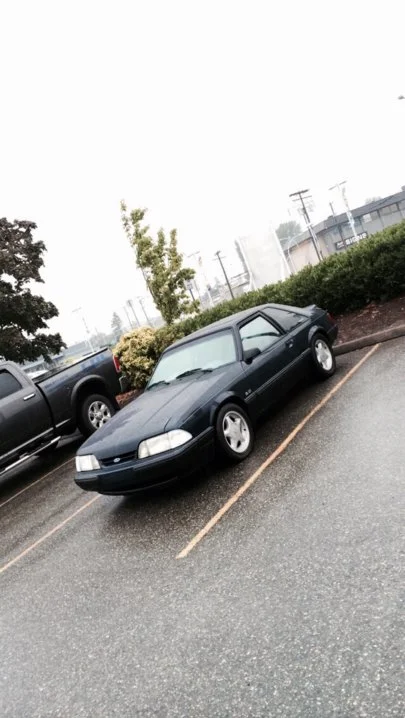

Hmm... Yeah if it's just a tad bit of rubbing on full lock I don't think it'll bother me. But I do have my car lowered on eibach sportlines... It's a fairly aggressive drop.
I really like the look of these wheels but I may have to find a 17x8 for the front if it's too much of a hassle.
There's a pic of what it's looking like currently(the 16" ponys)
