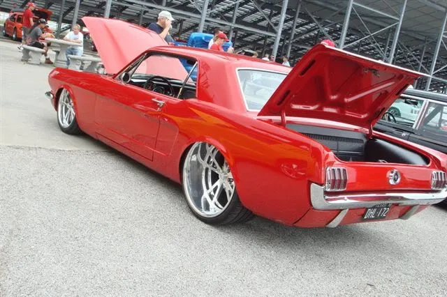

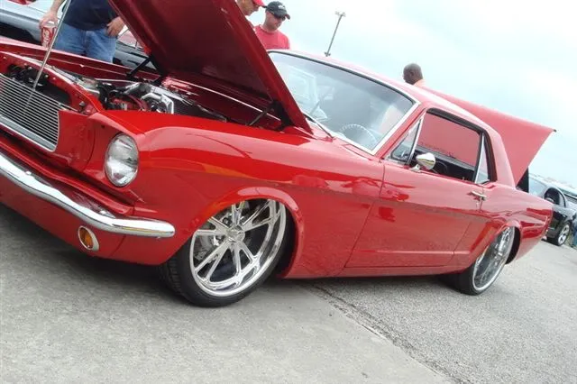

Let me jump in too! LOL! I understand both side of the arguement... and the guy really did personalize his comments with things like "for me" and in my opinion" so He's not one of those haters that has his head in the sand. Lighten up on him a tad.:rolleyes: My car has 18 by 8's front, and 18 by 10's out back. 4 inch b/s on the front and 7 out back... IN MY HUMBLE OPINION the secret to balancing larger wheels with sthe style of a vehicle that wasn't made for them is in the stance, wheel clearance to the lip, and overal style and appearance of the wheel itself. Trust me, if I ever see a "donked out" Mustang I'll puke on the spot ( hopefully on the car) but I have no issue with somebody engineering their way to sporting larger wheels and tires..... if it's done correctly. My 18's came from necessity, I'll be making big power and torque, and I want the silly thing to stop when I want it to, and how I want it to. Big brakes are a must, and they dont fit with small rims.The pics I've attached are a tad fizzy (sorry) and older; since then I've narrowed roe rear axel, mini tubbed, and keep in mind this is a full frame car now, and definitly NOT a stock suspension platform. 18's come at a hefty price, both in regards to time and fabrication/ expense. but if your project dictates a larger wheel and tire combo, then follow your gut.
That's just me.:flag:
KT.

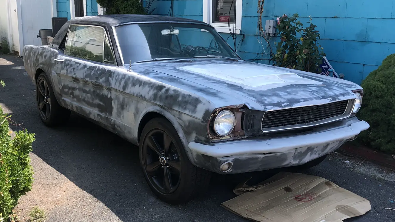

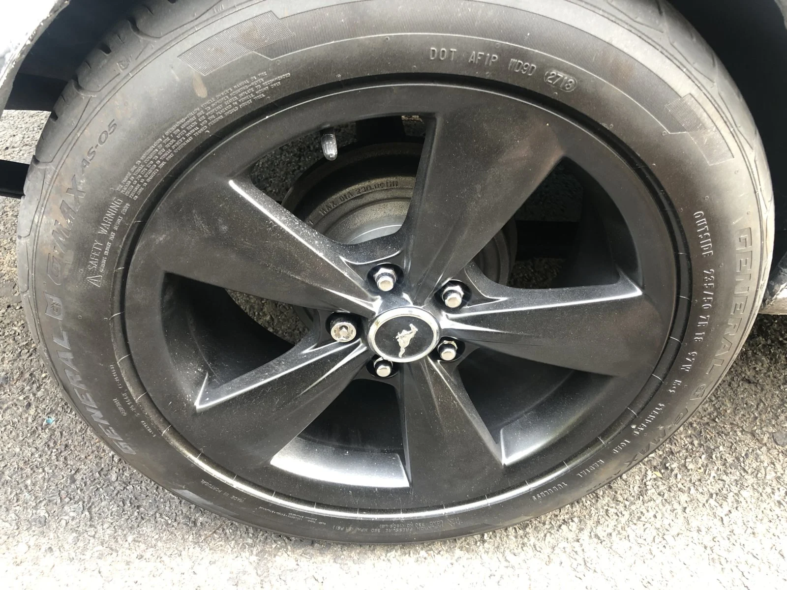

I’ve a 66 coupe and just installed new rims from 2014 Gt stang today, 18” 8, 44mm offset, with 235/50/18 tires. It’s definitely touching somewhere, didn’t get a change to look where yet. Anybody have a chart of the clearance ? Wondering if grinding or rolling the fender a bit would fix, or if I reached the max back clearance and just have to get other rims , which truly sucks because I love the look a lot. Thanks
