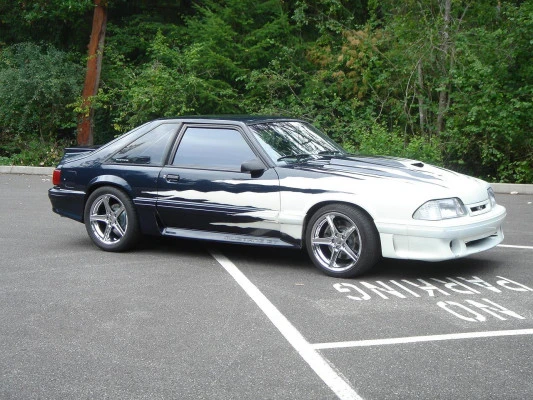

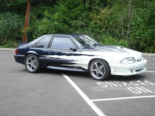

As far as I know 88SC_GT has 18x9's saleen wheels on his car. Looks really good. I'm not sure about the tire size or backspacing tho. Maybe he will chime in and throw a pic of his car up, shes quite the looker.
Nick
thanks nick, yea i use 18x9 saleens. 24mm offset, 5.95" backspacing. no issues.

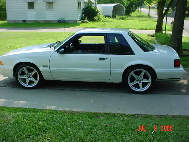

It's hard to tell because the wheel center on the white notch is dark ... and at this point, with only 2 posts to his credit, I don't think he'll answer. F'in tard :rolleyes:
With a 24mm offset and the way the rear looks tucked I would guess he did the ranger and lincoln 5-lug swap ... plus the rotor up front loks fairly small in circumference.
He's on corral all the time under "jbj302"
http://www.corral.net/forums/showthread.php?t=731610
From what I remember he did just did a 5 wheel drum in the rear and the lincoln rotors in the front. Try shooting him a PM.
