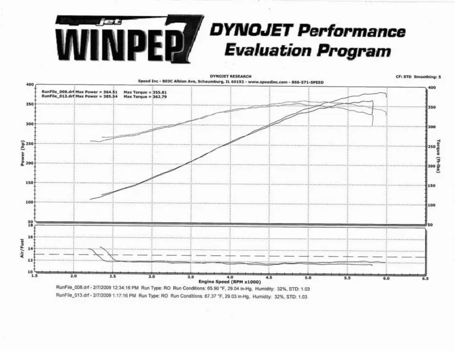

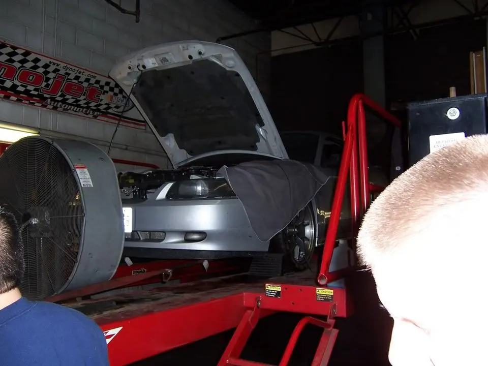

decided I need to do something fun this winter, so I installed a S-trim vortech on my stang and some 18x9/10 fr500s with 305/35 nitto dr's on the rear. I will get some better close up shots when it stop raining.
Tunning was done by Bob Kurgan, he's a really nice guy and he sure did help me out! It was fun to do though.

I have always heard 400 is the most you want on the stock bottom end, over on Modularforums there are several guys running stock bottom ends running 450-525hp at the wheels. Its all in the tune. These modulars are stronger then some think....BUT if you have a iffy or off tune, they will go kaboom easier at 450+ but you can get into the 400's with no worries
