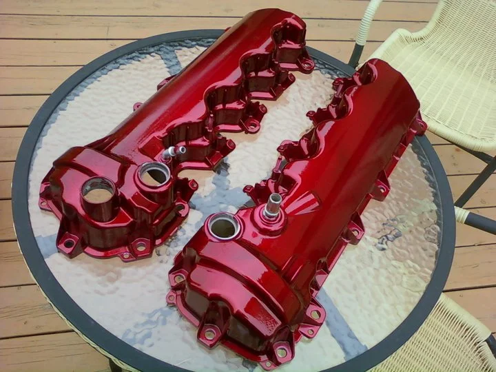

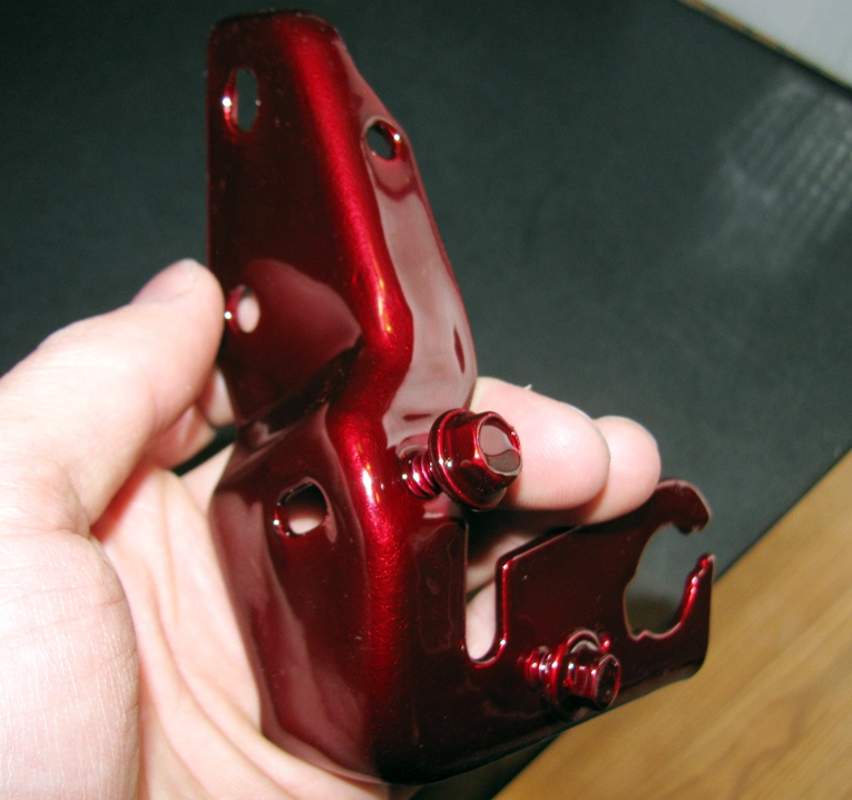

Doing some sample work for the candy red powder for my lower intake:
This red topcoat is more of a tinted clear as opposed to a translucent color on its own, which makes it tougher to lay properly. It came out darker than I expected but overall looks great. Anyone who's familiar w/laying powder will know what I mean when I say that it flows out like a clear, making for a very smooth and slick piece. Only trouble w/that is the color kinda bleeds a little bit and results in a less uniform color. What I was hoping for was similar to this color below (Translucent Red, a separate see-through powder to be laid over chrome similar to this candy red topcoat) but a little darker:
It looks great with good light but in darker situations it, of course, looks darker. For the lower intake I'm thinking it'll be too dark. I'm going to mess around w/more samples to see if I can get this to lay smoother upon shooting the first layer, which should have it cure a little lighter/brighter. Failing that, or if that doesn't work anyway, I'll pick up some of that translucent red the valve covers are done in and see if I can lay it on a little thicker to see if it gives me the results I want.
Whatever I end up with, the PS reservoir will be painted to match. The one I have on there is leaking, and I'm sick of the dealing w/the spray-on chrome crap that's currently on it along with its downfalls.

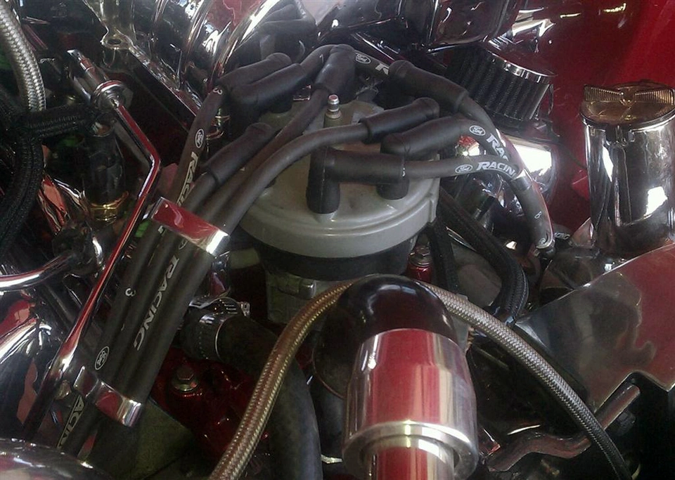

Decided not to put the discharge tube/bypass valve on until I can push it outside and do some cleaning on the lower areas that are all dirty so I can reach in to scrub it all clean. I might take some other parts from underneath off to paint them or otherwise neaten them up somehow.

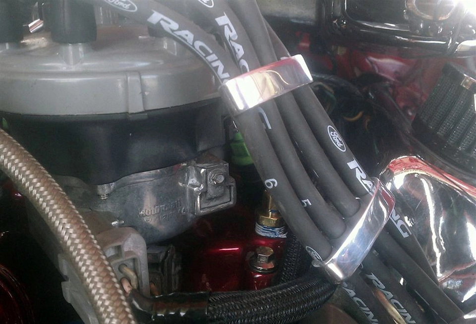

In the meantime here's a picture of the Billet Specialties wire separators I just got. Naturally they are sized for 8mm wires and mine are 9mm, so I spent this afternoon grinding them out to fit and then re-polishing them. They looked nice to start with but the shine is a little deeper now

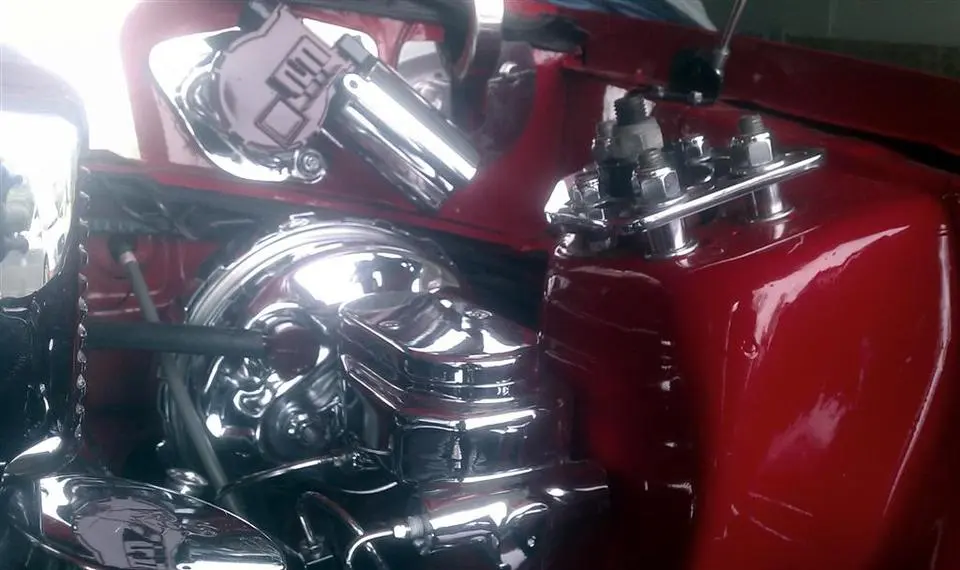

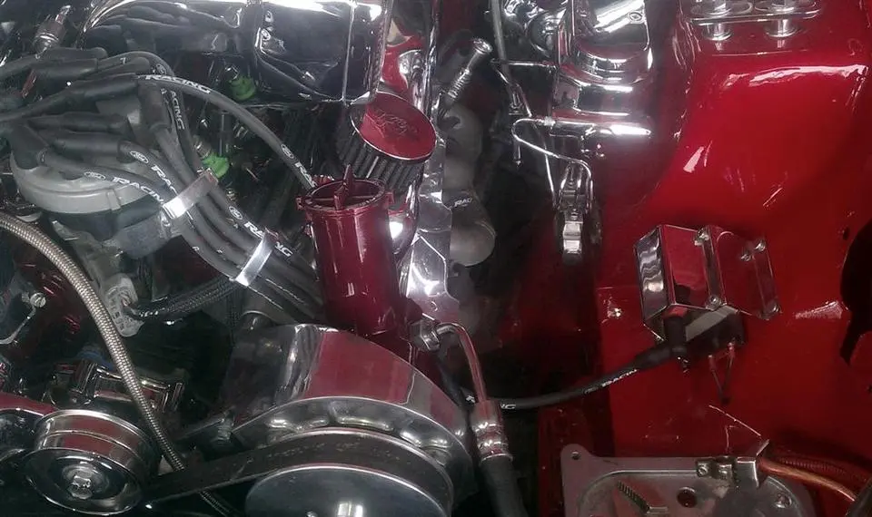

Swapped the new PS res. today. Also powder coated the drain hose clamp and rebuffed the pump bracket. Put everything left back on and it's ready to rock. I will attempt to start it up and go from there.
I still prefer the chrome PS reservoir buuuut after the bad luck I had w/the materials I refuse to try it for a 3rd time. The color is brighter in person just like the powder coat and the other paint, FWIW.

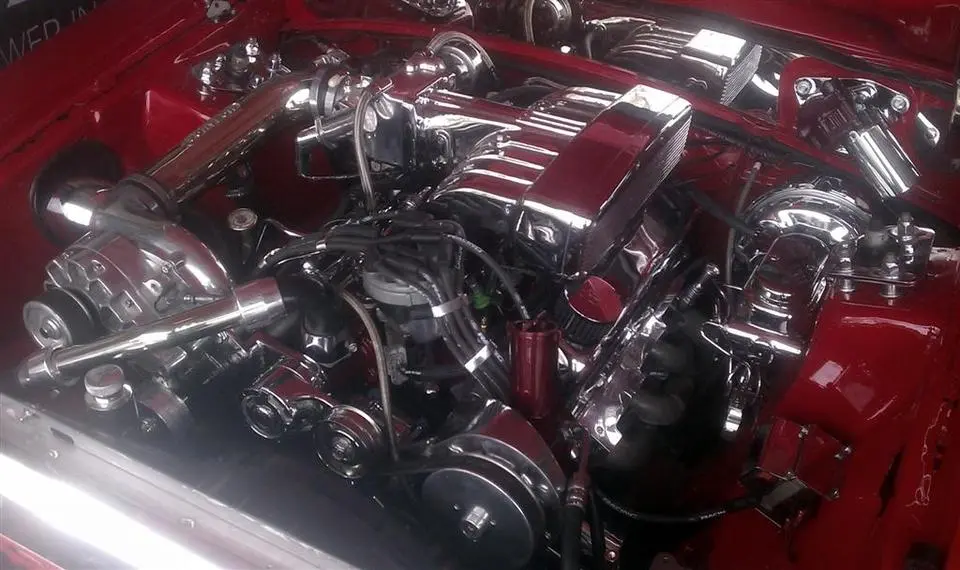

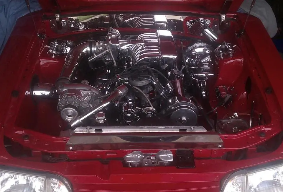

It's alive! Scott, you were right. I had to put the battery in after all. Who knew :dunno:
Got some stuff burning off the headers so I didn't run it too long. I only had it running a couple minutes because my electric fan is out. I had to re-install the distributor so I needed to remove it for clearance in order to turn the crank. Didn't feel like putting it in before I knew it'd actually start up. So since it was out I cleaned it up and will put it back in tomorrow (busy the rest of the day/night now) and see if I can clean up those headers to eliminate the smoke before I start working on the idle. It was idling fine but a little high, I'm sure I'll have to reset the timing but I've got it pretty close.
Throughout the day I also started cleaning up the wires in the fender to get them the hell out of the way so I can put the fenderwell back in place. Also the washer fluid reservoir needs to be mounted back in there and I had to get some stuff out of the way. Hopefully we're good to go as is.

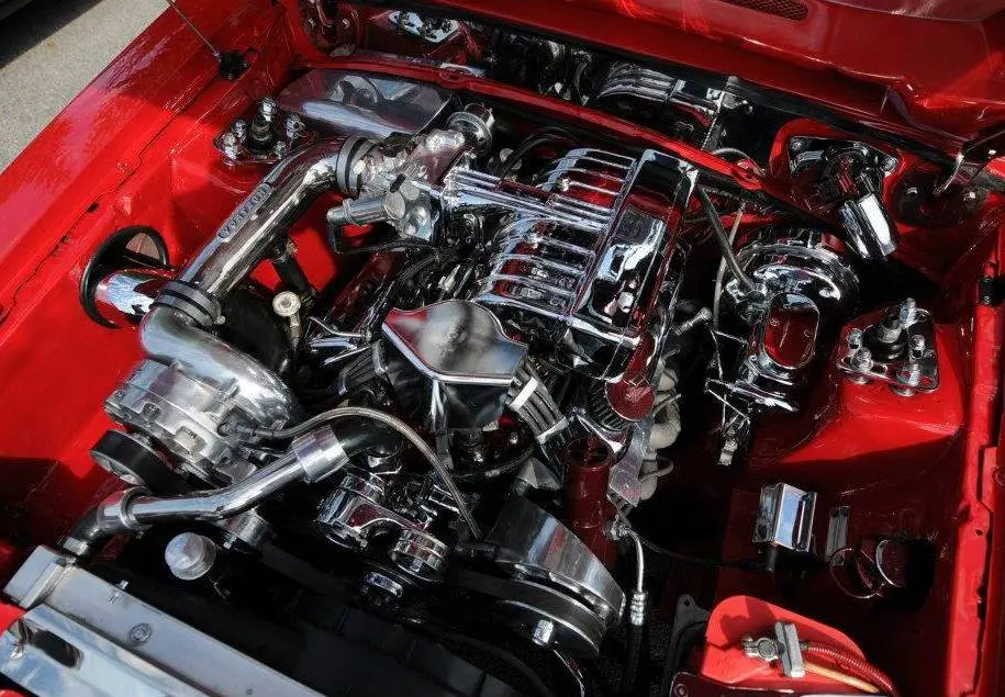

Here's a pic from a show this weekend with real lighting and a real camera Didn't get a good one of the console unfortunately.
